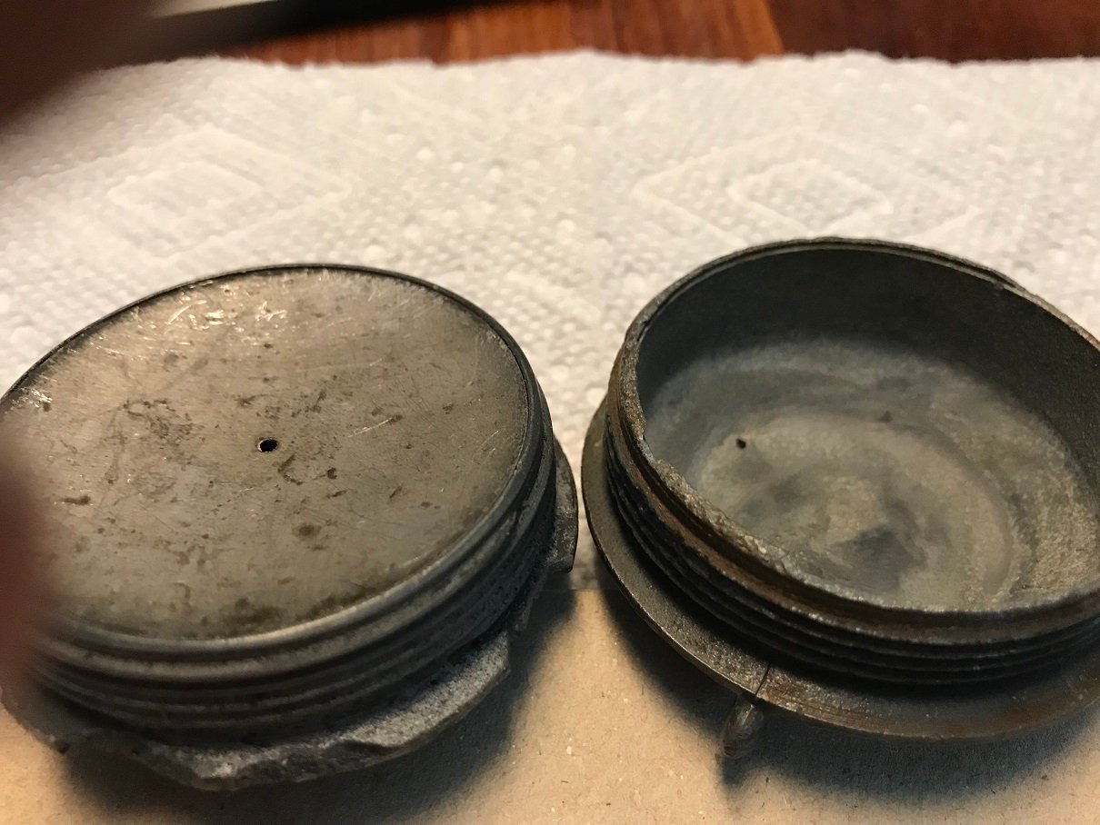

'24-'27 gas cap. Wings on outer ends, two=piece, baffle across bottom of cap to prevent slosh out the vent holes.
Original type cap for '24-'27

Hi Dan, thanks for posting. Do you know if it is made of steel or?

It's made of die cast metal, likely a zinc alloy, the baffle plate is a thin dome shaped steel sheet, soldered in place.
My original is now rattling too, as the plate is a bit loose from its solder.

I don't think the baffle is soldered, just the edge rolled over onto it. I don't see any signs of solder. Sure Henry found it cheaper to roll the edge than add the cost of solder. The one without the baffle is missing most of the edge (2 o'clock position). Agree in material used.
So you might be able to eliminate the rattle with a little tap on the edge or some Permatex Blue/Red

The original style is the two piece one. And yes, looking at the old cap seems no solder. Just assumed solder joint, guess that zinc die cast was formed around the thin steel plate when new.

Lang's sells the late style gas cap. I'm pretty sure they have the baffle too. Originals have the part number cast into one of the wings. Yes, the baffle was just held in by the edge of the cap being rolled over to hold it. Beware when buying and original. Many times the pot metal has swollen, and will not screw into the gas tank. Often, the baffle can be found in the bottom of the gas tank. Fordson's also used this cap.
