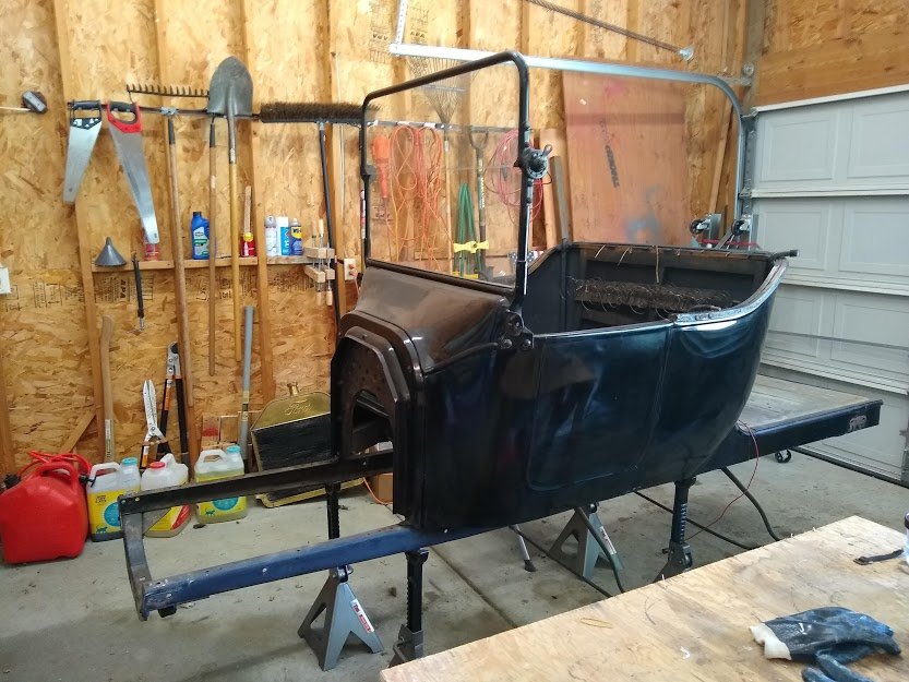

Here's a picture of the body before I stripped it, and after I primed and sanded it. I hope to start shooting black on the various chassis pieces tomorrow. The frame has been powder coated. After that I will be painting the body and fenders. That paint should be delivered tomorrow.
- Posts: 6559
Re: 1915 Headlight push/pull switch firewall location
Now that we've seen the body, you may wish to consult John Ragan again...this is different body than I think he has given you info for.
It looks like it will be a very nice car when complete

Thanks Scott for the comment. I actually talked to John last night, and he gave me the dimensions for the switch and data plate that I needed for my particular firewall. Thank you John for that information! Based on our discussion, I had to rework the edge of my firewall some to get it to fit nicely into the cowl piece. I am very glad I talked to you about it BEFORE I varnished and painted the firewall!
I think John knows more about T firewalls than Ford did. In fact, if you look at the Ford drawings, the last revision probably says "go talk to John Regan"...
John did mention that the drawings didn't have the holes for the horn though, and that they drilled them upon installation. I guess I'll wait until I get the firewall and dash shield with the horn tube cutout installed before I mount it. I recall that there's been some pictures of the horn installation posted in years past, but if anyone wants to share a picture of where they have their horn mounted on a 15 firewall, please do!

Looks like a nice runabout! Thanks for the pictures.
