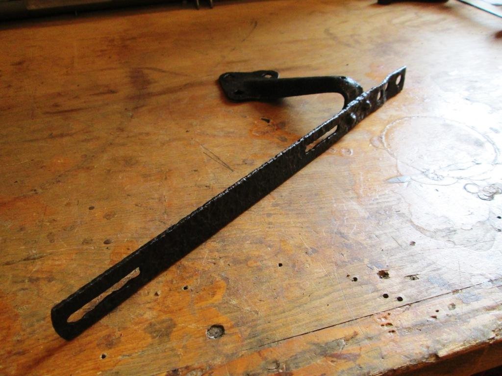

Here's what a pressed steel non-starter Touring bracket looks like.

Post by Erik Johnson » Tue Aug 06, 2019 5:13 pm
I learn something new every day.
I wasn't aware that there were pressed steel brackets prior to the change where the light and bracket were re-designed so the light was turned 90 degrees and had a large clear lens and a small red lens. I don't think I've ever seen a pressed steel touring or roadster bracket like shown above.

Where would the kerosene lamp mount to that type? That mounting is three holes. My car has only two holes for mounting.

Oh oh! When did that change happen?

Chris
The bracket for the touring car mounts on the underside of the sill, under the body. The bracket for the runabout, like in the photo Richard posted, mounts on the back of the cross frame on the left side, just below the turtle deck.
