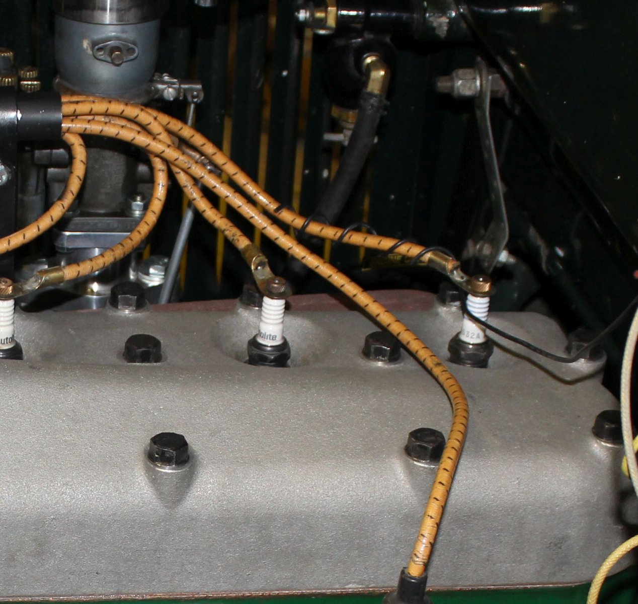

Mark, If you want a digital tack the pictures are of the components from a source on Ebay (they sell it in red or blue) and I show how I mounted the magnet ( I glued it to the crank starting pin) an mounted the pickup to the cam gear cover. You can see the magnet through the hole In the pulley. Total cost was $5.59 + .29 shipping from China. It works great.
