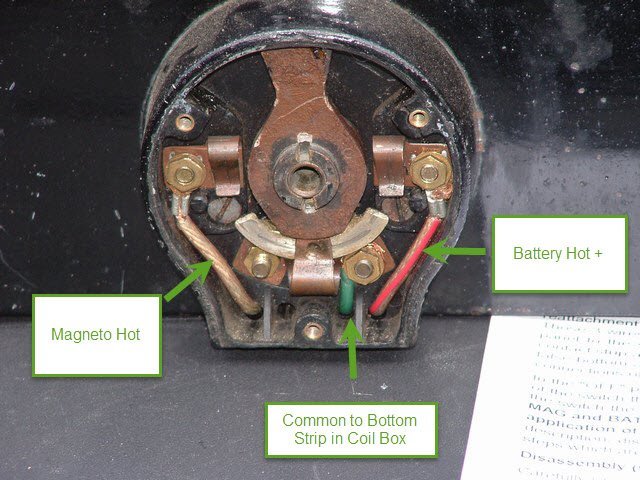

Since no current to the coils.
1. The coil box mounted switch is wired incorrect or wires are shorted.
2. The battery used for ignition is dead, or its not wired to the battery standoff on the coil box, or the negative terminal of that battery isn't on a ground path to the frame/motor for the timer.
As the drawing shows, the coil box has a top row of four terminals for the timer wires. Below that is a row of four terminals for the spark plug wires. And below that are two terminals for your choice of power sources. The terminal near the "driver's side" end of the box should have only a wire from the mag post attached to it, as the picture shows. If any other wire is attached there, get rid of it. Near the "passenger side" end of the box is the battery terminal. Mr. Ford likes to pretend that you don't need a battery, and that's what the picture shows, but we know better. You want a known good battery that produces six volts. If your battery happens to be eight or twelve volts, that's OK. One wire goes from the negative post of the battery to the frame. Be sure the metal-to-metal connection is clean and tight so you have a good ground. Another wire goes from the positive post of the battery to the battery terminal on the coil box. Again, if there's any other wire connected here, get rid of it, at least for now. So now you have two wires bringing current to the coil box, one from the magneto and the other from the battery. That brings us to the switch.
We'll use Dan's picture for this. It shows how the switch chooses the source of power for the coils. Turning it clockwise makes a contact between the wire from the MAG post to the wire in the center going to the coils. Turning the switch counter clockwise connects the (red) wire from the BAT post to the center wire going to the coils. So current is coming from either the MAG or the BAT and is going into the coils. It passes through the coils to that top row of terminals and is carried by the red, green, blue, and black wires to the timer. The timer is just another on-off switch. As the roller, rotor, flapper, or brush rotates it makes contact with each of the four wires, grounding each in its turn to complete the circuit and causing the corresponding coil to fire a charge to its designated spark plug.
The coils don't care where the current is coming from. They should fire whether the juice is coming from the mag or the battery. Since the car runs on MAG, we know that current is flowing from the post to the terminal, through the switch and the coils, and through the timer to ground. But the car dies when switched to BAT. So the circuit is broken somewhere before it gets to the coils. Your choices are: bad battery; bad ground at the battery or frame; broken, loose, or disconnected wire between the battery and the BAT terminal on the coil box; broken or disconnected wire between the BAT terminal and the switch; switch not making contact.
I can't think of any other reasons that current from the battery isn't reaching the coils.

If you can get out in that snow, a easy tool for simple wiring and switch of the Model T is an $8.00 illuminated continuity tester. Found at any auto parts store.
Best thing for switch work, has built in low voltage battery, and bulb. Lights up when circuit is completed.
On this switch, testing the key for 'BAT' and 'MAG' positions, to be sure the key works the contacts.
The clamp lead is on the COIL terminal, from the switch that would go to the common strip on the base of the coil box, where power would be, depending if from the magneto, or from the storage battery.
The tester pointed tip is now contacting the BAT terminal, and the tester lamp is illuminated when the key is turned to BAT position.
Then switched the key to MAG position , no light....that is good. No leakage and contact is good. Then placed the pointed tip to the MAG terminal and tester lamp lit again, as the key was still in MAG position, so that is good. Turned key to off, and tester lamp went off, so simple test of key switch is made with a test light.
