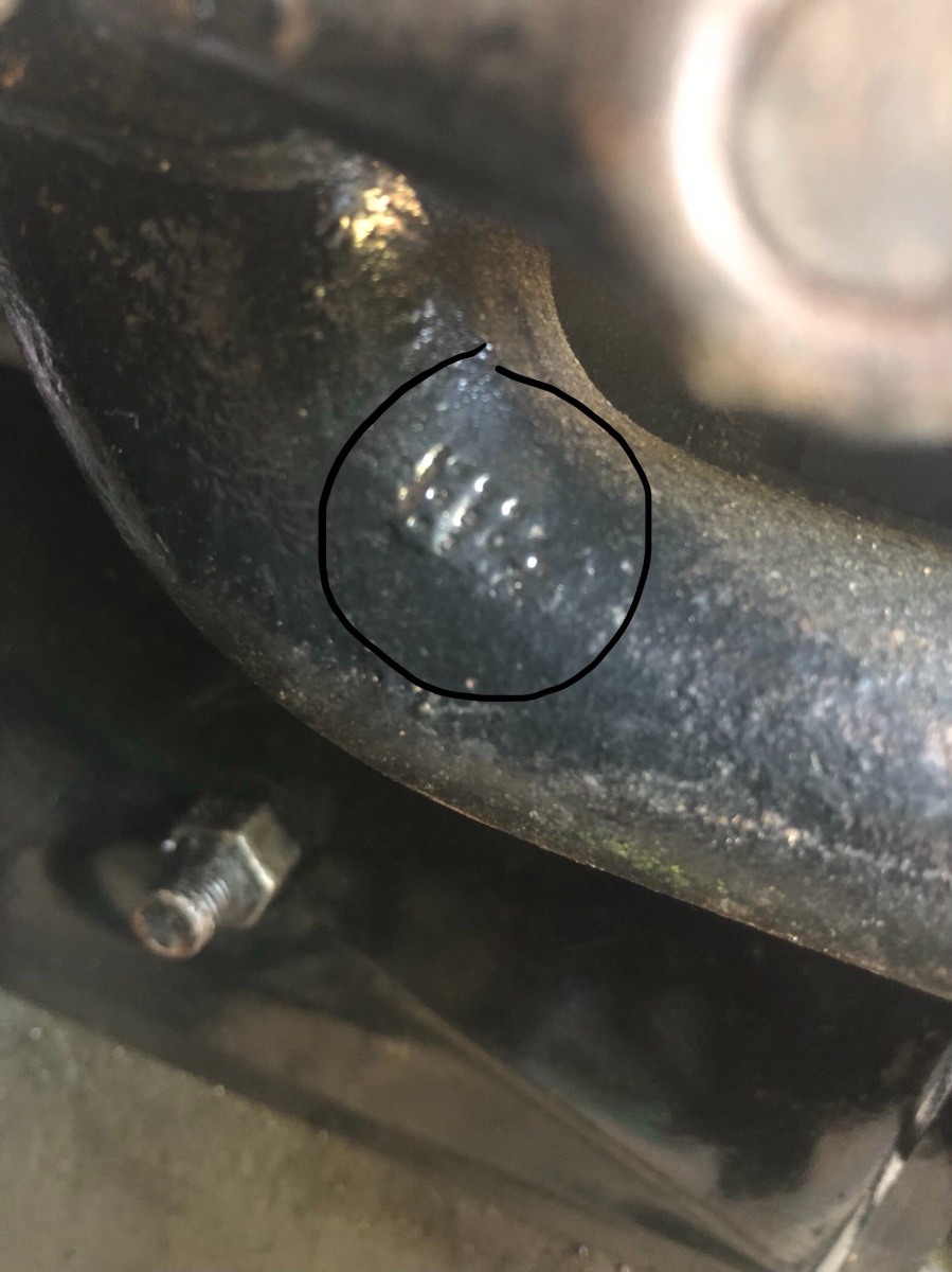

Posted before from my 13 touring, engine cast date 12-24-12. Bruce's book put engine assembly as 1-24-13 (from memory) so this head could be the original to my engine. Car last registered in 1928 but heads can be changed so take all this for what its worth. This is a low head and the only one I have seen so far but have been told others had seen them.

This is the low head on my 21 Touring. No it’s not correct for a 21 but is a low head I had from a 17 engine.
You can see the casting numbers that’s on it. So the question is what do they mean.
The numbers on the back of the head are 2 3 27. And yes it is a low head.

John: That’s the type of numbers I found on a couple heads. I was thinking if the number on top ( you case that is a 2) might be say a shift number. It does make any sense as a month number.

The head came with a disassembled 17 engine and transmission. And I am assuming it’s from that engine but not 100% sure. To me the numbers on the back of my head look more”modern” than the older low head pictured. I guess we will never know for sure but it’s quite possible the low heads were still in stock at dealerships or were in overrun parts areas in the factories and they were used up till they ran out then the high heads went in production. I don’t think Ford would have melted down the low unused heads but what do I know. Another Model T food for thought I guess.
