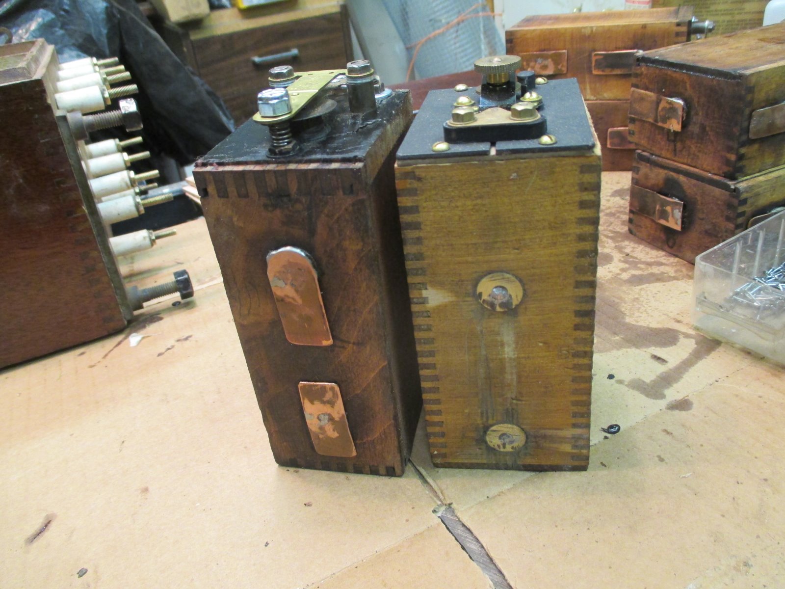

Post by KWTownsend » Fri Aug 23, 2019 6:58 pm
Bill-
I have altered KW type coils for use in Heinze coil boxes and Jacobs Brandow.
It is not difficult, but very time consuming.
I cut the dovetails deeper on the tops and bottoms of the coils to get the right size. Originals Heinze coils will work as the box has no modifications.
