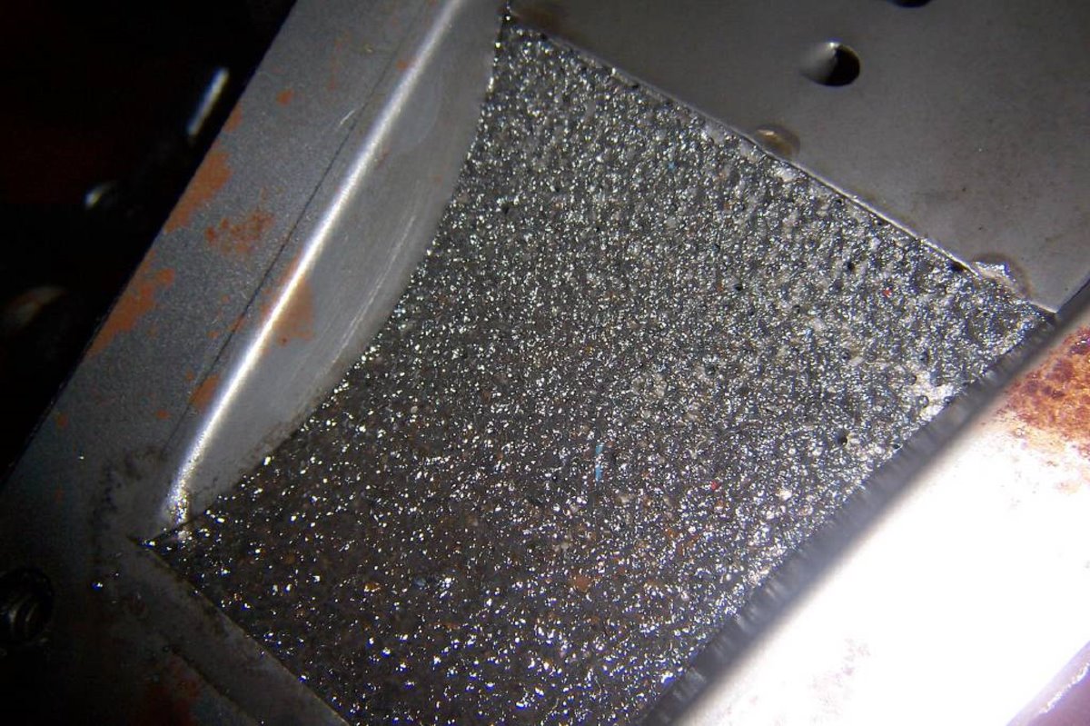

IMO, the new Scandinavian linings won't last very long at all. The formula for the additive to bind the cotton fibers and make them heat and oil resistant is the cause. These NEW Scandinavian linings are very dark black, stiff, and are rather thin in relation to the pre-new additive.
Older version on the left is brown, and bit thicker, NEW today's lining, dark, stiff, thinnest.
MY result in using these around 2001 in the 1924 was a huge amount of debris or 'sticky tar' from the linings, filling up the oil screen. To my dismay the brake band lining didn't make it though a Nat'l tour in Virginia, the few hills there took the toll. Linings were less than a year old.
The better is Kevlar, it is the proper thickness, and has no additives to break down. Tough and will last and last. Same Kevlar in the 1924 since, still going and going like the Energizer Bunny
Kevlar compared to new Scandinavian lining showing physical feature
Your choice, but for me the Kevlar is better. Even think a comeback will occur for all those non-demountable bands folks overlook and discard, you can line those with Kevlar and won't have to remove them for a super long time.

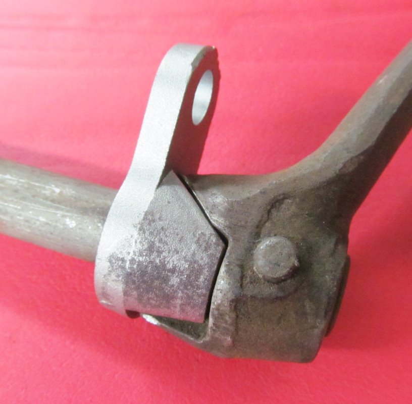

The 'cams' are of course on each brake and reverse pedal, forged to the pedal with the shafts replaceable.
The other 'cams' are the pedal supports, these are bolted to the outside and inside the hogshead.
The low pedal or clutch pedal has its 'notch' which is also a cam riveted to the shaft, that 3428 notch is riveted after you remove the old worn one, or when placing a new low/clutch pedal shaft.
Normally the reverse and brake pedals are good, if not, you have to find better pedals with good cams. The supports and notch are made new today, and are very nice reproductions, those are the parts that normally are changed, along with new shafts when you restore and rebuild a hogshead.

How can I tell if my cams and shafts are worn and need replacing? (They probably are) Do I change the pedals out too?

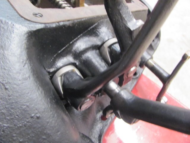

Does that mean the cams are worn and need replacing? Do the pedals also need to be replaced?
The best way to judge part condition is visual, with the hogshead off, easy to do restoration. If you only want to examine, you can loosen the nuts and washers on the bands, allowing the pedals to be a bit free swinging, then judge the action of the interface between the pedal cams and the supports.
Typically, the low speed notch needs to be in good shape, or else the setting of 'free neutral' is compromised by too much slop in pedal action.
The supports for the brake and reverse are normally worn down, so you need to check condition of the gliding surfaces of the cam.
You can see the wear compared to a new repro support.
Back in the day you could just go to the Ford parts dealer or agency and get new pedals too! Today we have to contend with finding the better used part, so your pedal needs to have appropriate wear to be usable with a new repro support.
Used pedal with used support, note the amount of 'slop' existing before stepping on the pedal to engage the cam action to squeeze the bands.
Same used pedal, but with new repro support, just about a good as you can have without NOS pedals

I should probably go with 'over sized' if my slow speed pedal shaft is deflecting when I grab it with my hand and move it back and forth?
Wouldn't need oversize IMO. There should be some 'movement' up and down, guess you have to measure and test. Do you have the hogshead off? Have you removed the pedals and shafts to measure?
The brake or reverse or low pedal shafts, new repro , will measure .624-.625"...the oversize is .630" but you will have to ream the pedal and the hogshead boss to fit. If you worry about leakage of oil due to worn boss on the hogshead, then do the O-ring trick, easy.
On this rebuilt with just std. new repro shafts, the fit is OK, can lift up and wiggle the low speed pedal vertically just some, but that is serviceable. The supports and cam action is more important than super snug fit of the shaft into the hogshead IMO. Now the early alum hogshead can be worn much more due to the soft metal, but the iron boss are more resistant to wear IMO, just depends on how worn out or wallowed out are the boss holes in your hogshead!

I don't know if anyone mentioned it yet but low/high pedal does need some movement in the cam or you'll have no neutral.

I've inspected it more:
The slow speed connection clevis to the clutch lever has play in it as well as play at the connection to the pedal. Will a new slow speed connection fix/improve this?
How does one chamfer the cams to do the o-ring trick?
The slow speed shaft and notch deflect substantially by rocking the pedal back and forth. How does the slow speed shaft seal without a cam on the outside? What does the slow speech notch notch into, the hogshead case? Do I have to remove the hogshead to change the slow speech notch?
Is the transmission band tool worth getting for installing Kevlar bands? My bands appear to have the removable ears.

Just figured out that there is a clutch pedal support cam on the inside of the hogshead that is replaceable.

The surgery has begun! I have all the bands out and the old cotton removed, the Kevlar bands are going on now.
Question 1: With the hogshead on and the bands removed, what tool is used to hold the clutch pedal support bolt head on the inside? This is so I can take the nut off on the outside and replace the clutch pedal support. Is it possible to change the internal clutch pedal support and do the 'o-ring trick' without removing the hogshead?
Question 2: The pedals are worn. I am changing all the cams. Can the wear surfaces of the pedal be built back up again?
Wish me luck!
-- IV
Wish me luck!
-- IV

Very interesting comments relative to scandinavia, kevlar and wood linings. I agree that the new scandinavia lining is not what it used to be and many go to the kevlar. I once listened to a debate on the use of kevlar and one person whom I respect was very strong on not using kevlar for the brake band as heat could cause the drum to burst. He apparently had that problem (right or wrong) and I decided to use wood, cotton wood. I have used the wood bands for several years in the 1912 hack and adjusted them once soon after installing. Smooth operation, no chatter, and no wear on any of the three bands. Just my 2 cents, Dick C.

Sure you can. Building up worn parts isn't hard, If you're talking the shaft cam(s), build up the surface with a welder and then dress them back down to the original profile. Just know what the profile should be originally and take your time dressing it down to match. EZPeazy, just make sure it's smooth smooth. I remember someone used to sell replacement pedal faces, if that's where the wear is, you cut off the roached out ones, weld the new ones in place, and dress the wekd bead down so it vanishes... paint and reinstall.

When replacing a couple linings in the 24 in 15, used a spare drum here to be sure the bands were round in a relaxed state, clamped down on the drum too and would fit nicely on the drums in use.
Drum on the lap and started tweaking the re-lined bands around the drum. Found the bands were very tweaked, re-tweaked them to be quite round and fit nicer on a drum. Perhaps find a similar to your drum size if you don't have a spare, check your re-lined bands, tweak them to round again and be happy. Carefully installing the fresh bands. I used modern cotton linings but have seen photos here of poorly installed Kevlar linings that stood proud, away from the steel band itself in between the rivets. Yikes.
I riveted the ends of the lining first, stuffed the kidney shaped lining down into the band and kept riveting so it was snug on the band.
Susanne has good ideas too. We can!
Keep us posted!
