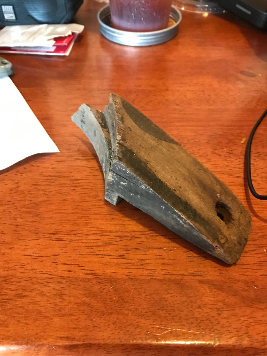

I know these are important and I hope I can find the other one, because I don’t want to have to make it.
They have separated from their parent wooden pieces. These are supposed to be the bottom of the door pillars on either side of the rocker panels to form the bottom door opening.
As far as I can tell, the one with more meat (that I fixed),is a rear and the skinnier ones are fronts.

The holes in the original rockers line up with the holes in these. In fact, the hole to attach the one I fixed would be located directly in the splice line (where new meets old)

I found the fourth one, so now I can start rebuilding these.
