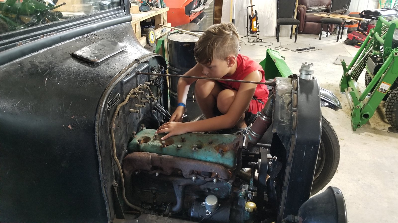

In 2 weeks it will be a year since the last time my T ran. My valves led themselves to a slow death and ended up giving me no compression on 3 cylinders. One thing I learned with this car is to take things slow. So I slowly started the rebuilding process. I had to ream out the rearmost valve guide which meant removing the engine or the firewall, I chose the firewall. Got the valve guide reamed, cut all new seats and installed new valves and springs. Buttoned everthing up and she started right up. Sounded great except for an exhaust leak at the back port. So I ordered up some new gaskets and will try again. The last time she drove down the road was for the local parade, hoping to have it run again this year.

Today I changed the oil and put the new manifold gaskets in. I went with the individual gaskets for the first time, those are way easier to install. Car fired right up and purred like a kitten. I then started off on the road to put some miles under it. I probably put on 50-75 miles chasing around today. I picked up "the help" from his first day of school! He was so excited to see the T. Then we went for a sunset cruise. Tomorrow I'll take her to work and hopefully start daily driving it again.
