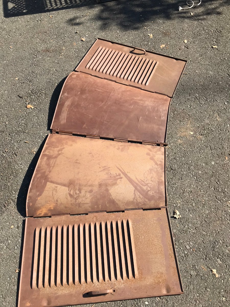

What is this hood?
Anyone?

Jeff, the first(rusty) one appears to be a '26-'27 hood. The second one(primered) one appears to be a repro hood for a '24-'25 high radiator. Dave

David S is right on!
- Posts: 4687
Re: What is this hood?
I think David is correct, however, the side panels are on backward. The louvers should be facing out.

I agree with the others. top is 26-27 and the bottom is repro 24-25. I would love to come and play "Clue" with you. but the commute would be a little rough ..
Just keep posting the stuff here, we will all help figure it out .....

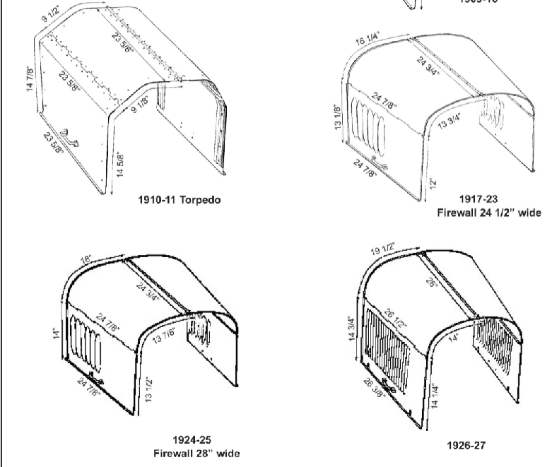

I think Langs has measurements on their hoods in the catalog. Can be confusing if sides are on wrong side.

Had to look twice but the lovers are indeed on backwards on the 24-25 high hood. The panels are in great shape. In the 24-25 hood pic it looks like the panel in the right corner of the pic is a low hood panel. Maybe!

This is great. Right down to the backwards side panels! It was a puzzle. There are just dozens of pieces everywhere and Im piecing them all together best I can. I did match the bottom one to my '21, so that wasn't too bad. This guy loved rust colored primer. Better than rust by itself I suppose!

John kuehn wrote: ↑Mon Sep 09, 2019 9:39 pmHad to look twice but the lovers are indeed on backwards on the 24-25 high hood. The panels are in great shape. In the 24-25 hood pic it looks like the panel in the right corner of the pic is a low hood panel. Maybe!
Good eye. That's yet another set entirely. That's the one I matched to my '21.

Maybe a repo also but not sure.

Hood dimensions

Fellers, look again at the '24-'25 hood. The panels aren't on backwards, your looking at the shadows. The dimples for the hood hooks bear this out.

Yep, never mind. I was thinking about them being on inside out, backwards didn't register. Yeah, I looked again.
