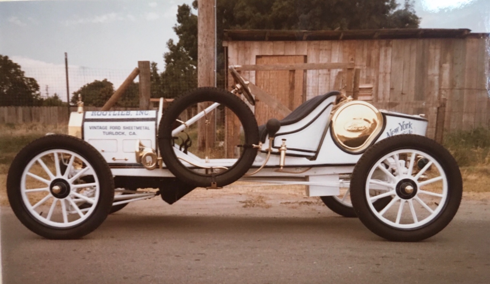

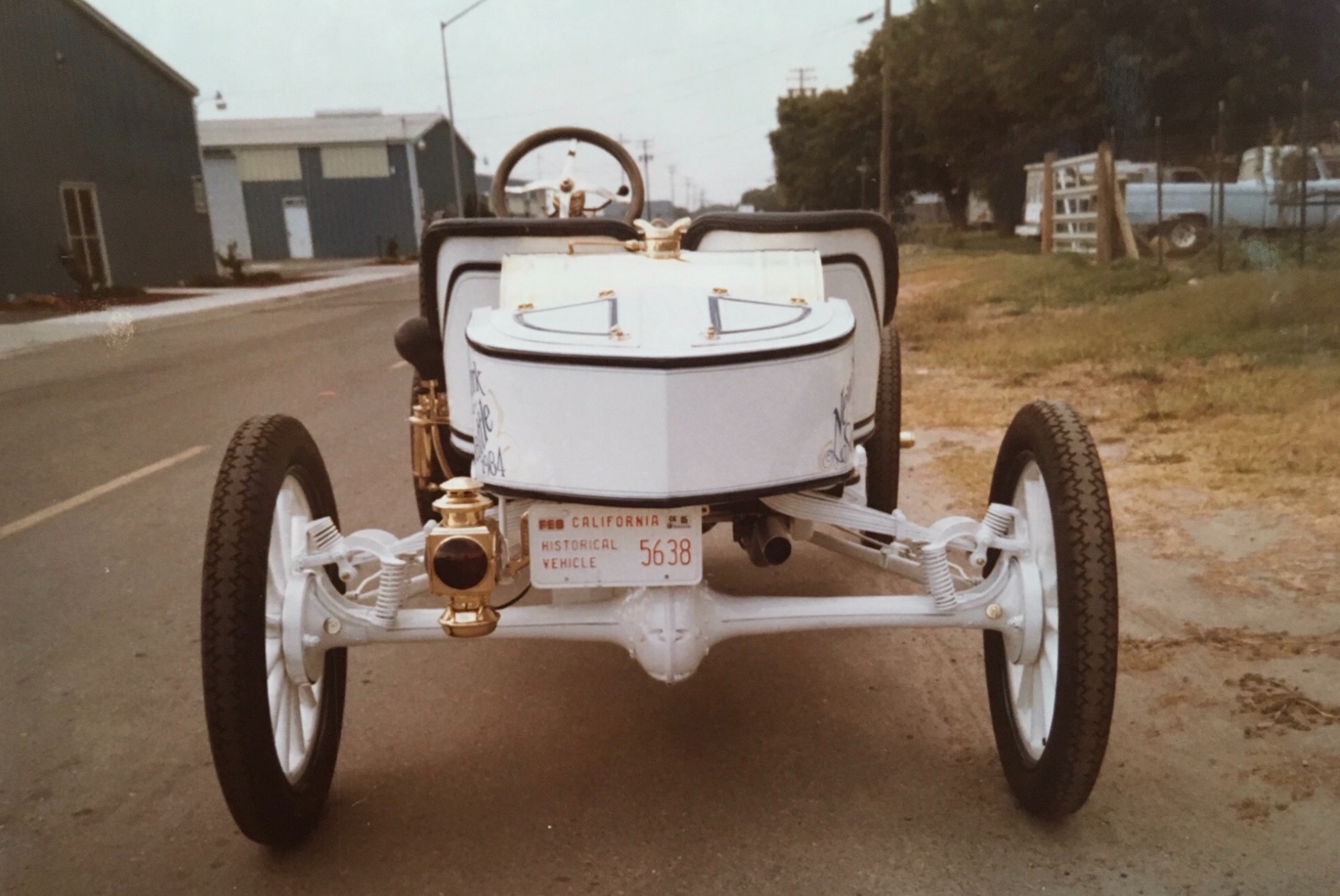

35 yrs. ago I remember seeing a little article in Old Cars Weekly, that the MTFCI was going to rerun the 1909 New York to Seattle race. I thought that would be fun to go on, so I contacted the person in charge and was told that the entry list was full with about a dozen on a waiting list. It was still 6 mo. before the run so I thought “well maybe”. So I had an idea for a car, so I started to gather parts. I wanted to build an early car, so I found a 12 rivet rear, tapered springs,early spindles, wishbone, tie rod, etc, etc. Got 2 frames, one with bad front and one with bad rear. Cut the bad ends off and zeed the rear section to give me a 4” step. Got a 4” dropped axle from Mor Drop and sent the wheel hubs with new rims to Vintage Wheel. In about a month I had all the parts to assemble the chassis  Sorry these are pictures of pictures.If you want to comment, please wait till I have loaded the whole story.

And that’s as far as the build got for some time. I had not heard from the committee so I assumed I was out. Then with 4 weeks to go I get a phone call saying that I have been accepted and they are looking forward to seeing me in New York City. Holy shit! I got to get to work. So with the help of friends and family we tore into this project working 20 hr. days, 7 days a week. It started by using on of our speedster decks and cutting it off where the frame stepped up. Then making a gas tank to fit the step up area and using cardboard to mock up the tail end. Then using those looks to finalize the wood frame work for back of the body. Once woodwork was done, covered with sheet metal and appropriate mouldings. Then into paint and plating and polishing.

Then with a week to go we started to assemble the car. Everything went pretty smooth and I’m sure there were hiccups that I don’t remember. Oh- one. The cyl head was no good and had to be changed at the last minute.  And lots of little things had to be adjusted, reworked or fabricated. But with so many hands it made it much easier. So we fired the engine the night before we were to leave. Cyl. head leaking. Luckily I had another low head, so we switched it out. Ran fine. Adjusted the bands. Backed it into the street and went down the block and back. Everything works. Put a skid under the car and lifted it up, took the wheels off and loaded it into the back of the pickup, covered it up, went home and slept for 4 hrs. and left for New York the next morning.
