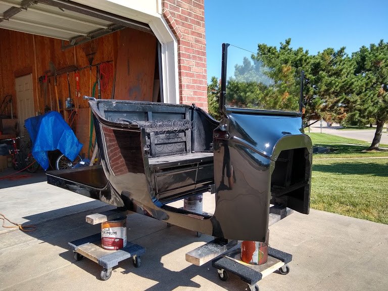

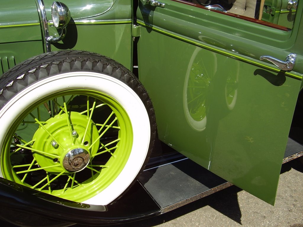

Attached is a photo of a 1930 Model A Town Sedan I painted 10 years ago with PPG's Concept paint, catalyzed, sanded and buffed out. I shudder to think how much this two-tone paint job with window reveals painted lower body color would have cost if I had taken it to a "professional" paint shop!!! And then there were the green wheels and the black fender/splash aprons. YIKES!!! $$$$$$$$$$$
And yes - a paint job is 90% preparation, where the REAL work is.
