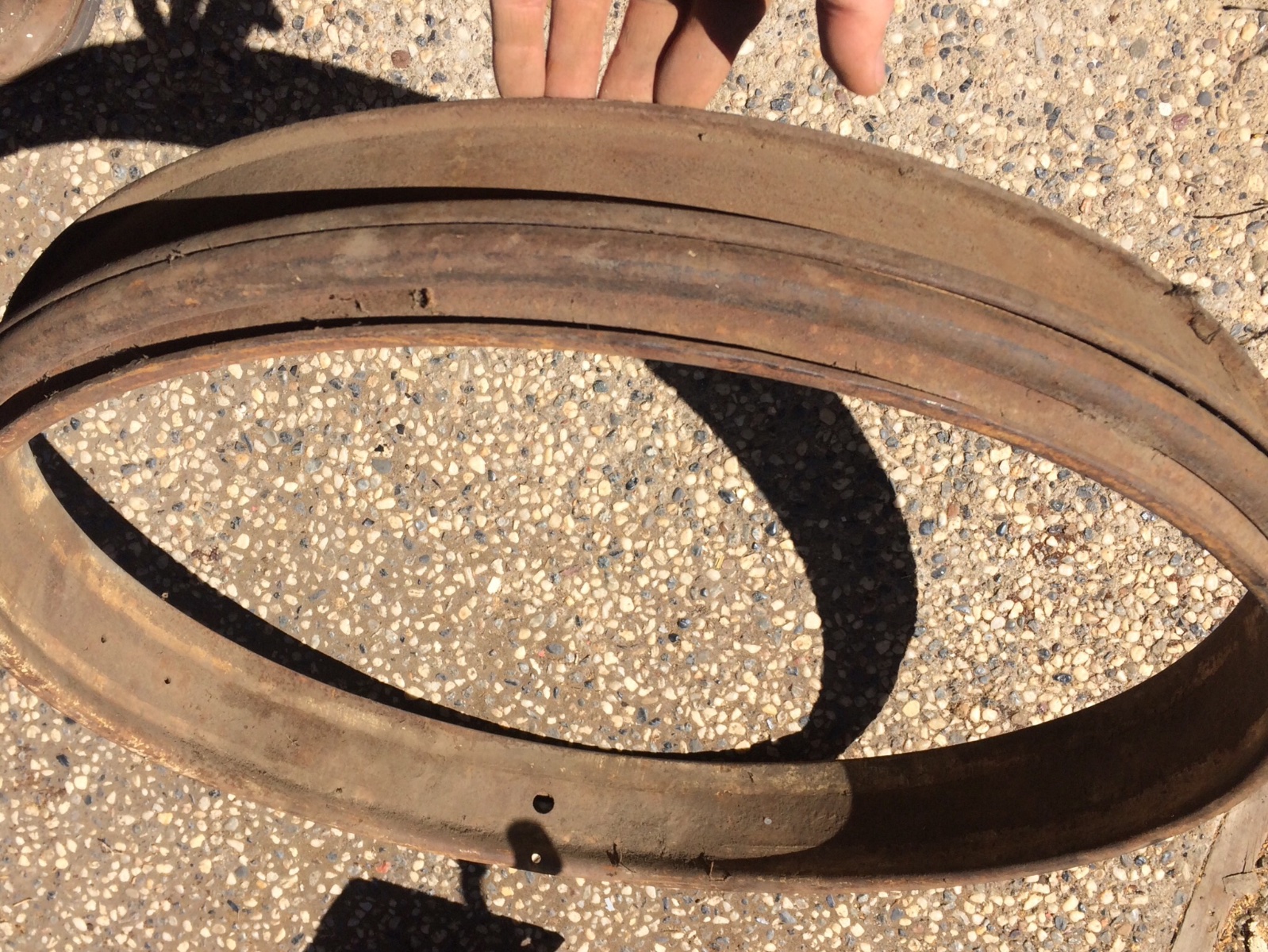

Dale, Thanks for your response! I’m starting from knowing zero about these. I will post the most complete set first. For the type I have three rims five rings and one split rim. So this means I have only one complete. (What I’m realizing is what I have is literally a mix match of lots of parts. But trying to figure out what goes with what.)
This one the actual diameter is 25”. And it’s stamped to fit the 32 x 3 1/2” tire. This shows all four pieces (the rim, two rings, one spit ring).

This one I have the wood in the hub inside. I don’t know if the wood or hub is original to the rim. (I actually have two of the rims.)
The sizes the same 25 inch diameter that takes a 32 x 3 1/2” tire. This is very similar to the above, but the grove is rounded on the bottom as opposed to triangle shape.

Re: I need help identifying detachable and split rims and wheels.
Matt, the first one is standard universal earliest style with the back side rolled for clincher tire about 1909'1910 later S U rims used 2 bead rings. You can tell these lock ring by the triangular groove and the tangthat fits in the hole in the groove. EMF used this rim 1n 1909 and maybe 1910. Buick might have used this rim also on 1909 two cylinder cars. The second one you show is Goodyear brand as you can see stamped on the rim. I don't recognise the hub but Buick used this rim on 09 and 10 2 cylinder cars as well as the SU rim. Reo used this rim on 08, 09 and 10 two cylinder cars. It was used on other makes as well. They came with straight Side rings as well as clincher rings the lock ring was flat with round edges to fit the grove in the rim and has a tang to fit the hole in the grove. Are there any 25 inch bead rings, perhaps the two that look blue Gray in the picture
