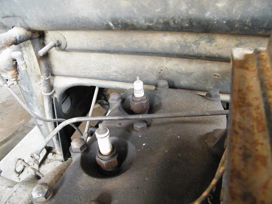

Mark is correct.
As the straps are flexible, when you hang them from the hook end, they have to wrap around the cowl tank, just like your belt wraps around your waist ;)
You want your belt to be long enough. :P. You need those straps long for ease of entering the holes in the firewall.
IMG_9275 (600x589) (500x491) (470x462).jpg (139.59 KiB) Viewed 4068 times
