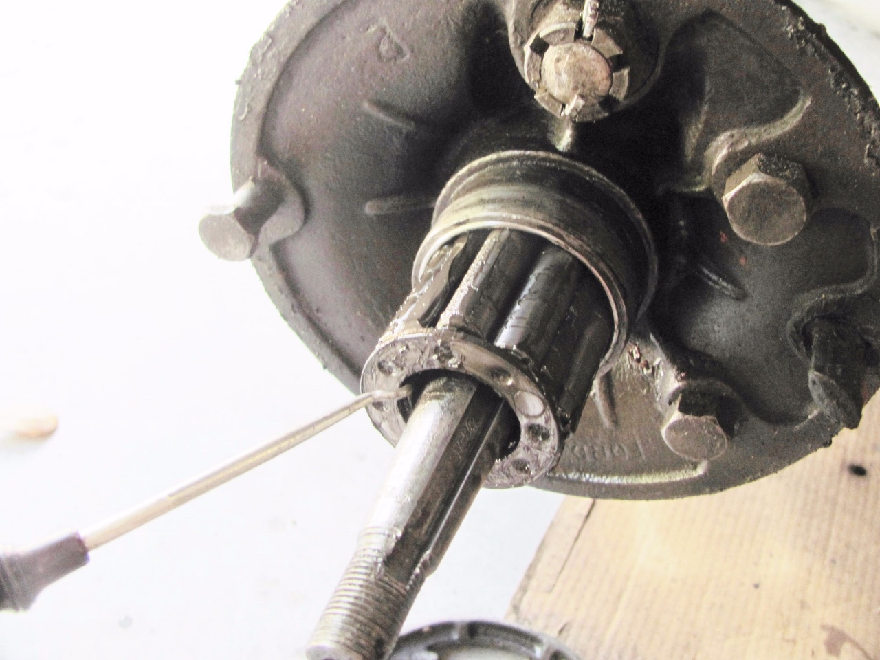

Found a stiff small hook works, something thin to get to the edge of the carriage and the axle.
This one from the wife's sewing basket is good :) Plus wiggle the axle or as Scott said, rotate opposite wheel to turn the axle shaft as you pull out that bearing.
Some use a coat hanger or stiff wire.

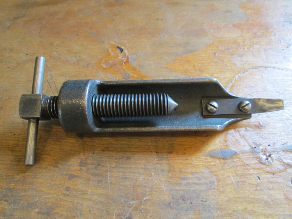

Here's the tool Stevens put out - works very good.

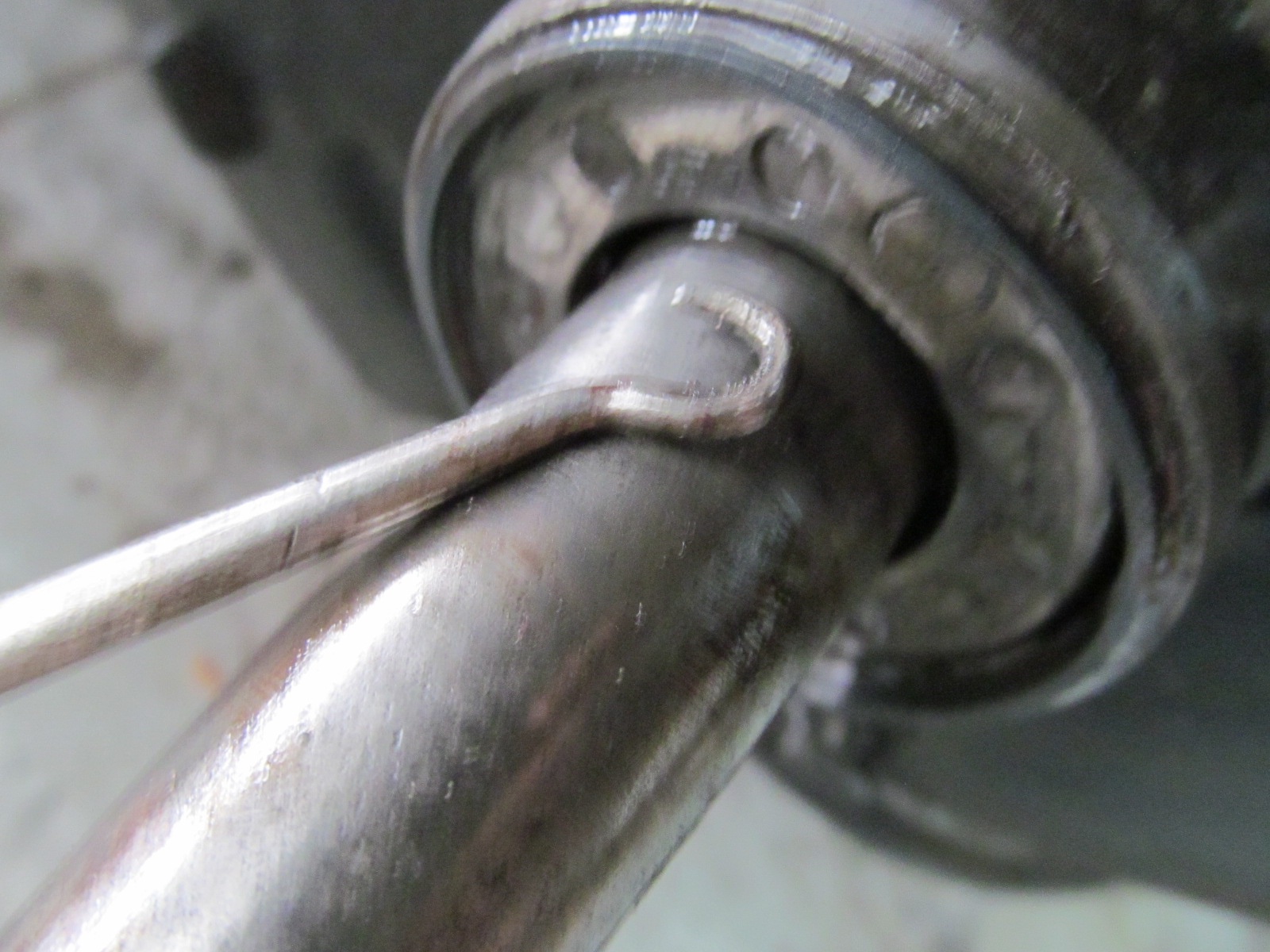

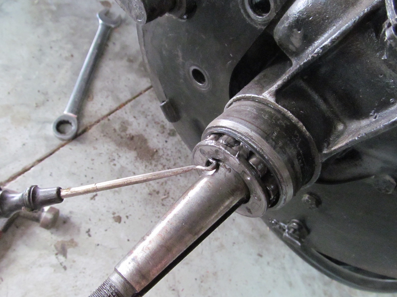

Using an antique button hook, mine has a bakelite handle, antique store find, $5.
Slips between axle shaft and bearing outer carriage.
Just removed these bearings today for service of the rear axle.
