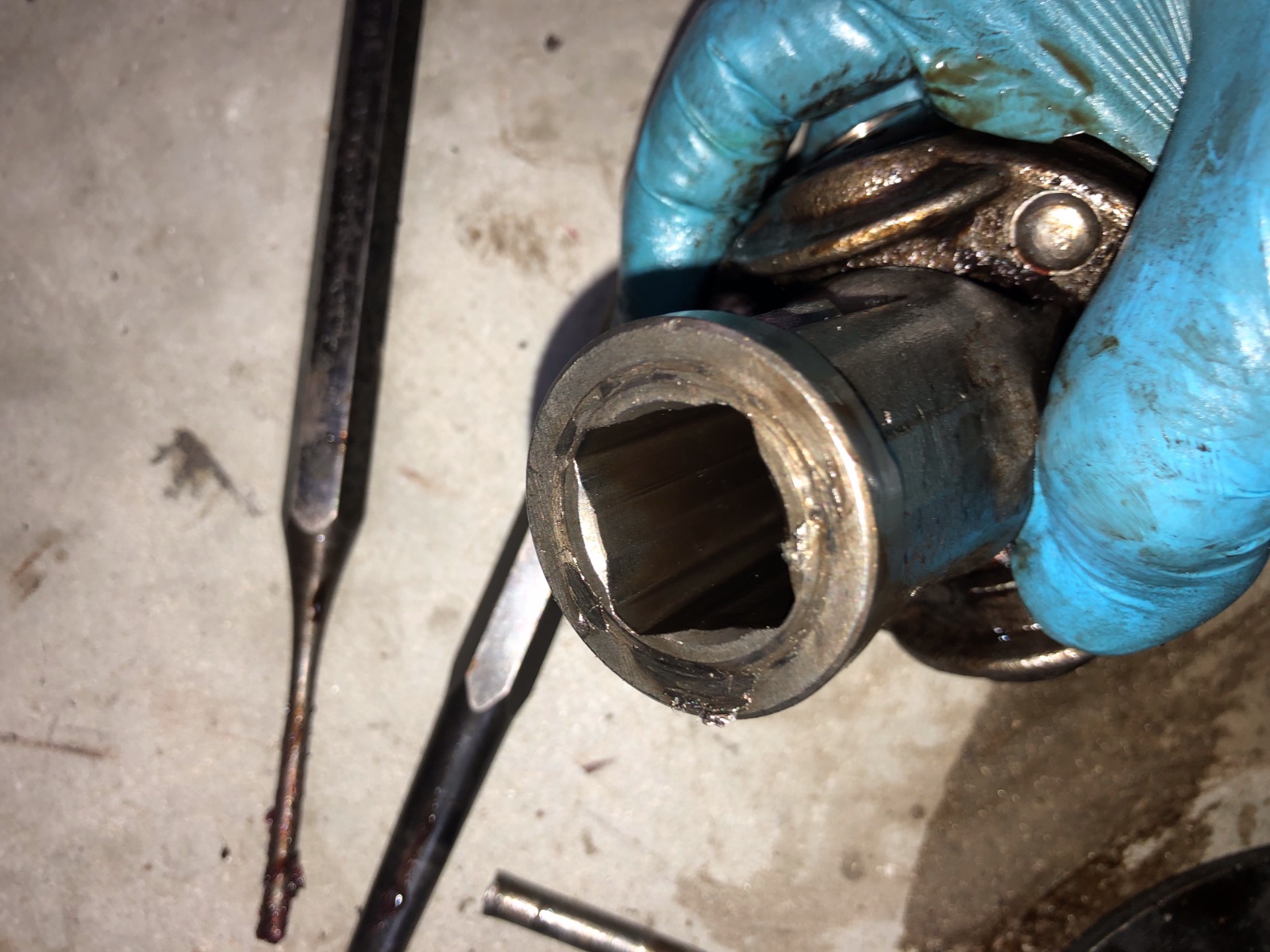

Since I am 'chasing' a noise from suspected rear, could be the driveshaft, so will look over it first, the u-joint seems a bit too loose for and was surprised to see such little grease, just oily film, as being washed by oil, and I always chock it full with the grease gun. And don't remember if the front bushing was a needle bearing, need to check that, the pinion is modern bearing and it seems good from outside inspection.
After removing the drive shaft, and I put the ball cap 'up-side down' with oil hole down, to prevent oil seep to u-joint, that doesn't work ;) Going back to Ford way.

As for the noise, suspect now driveshaft. Pulled the u-joint and noted wear in places on the collar toward the front bushing.

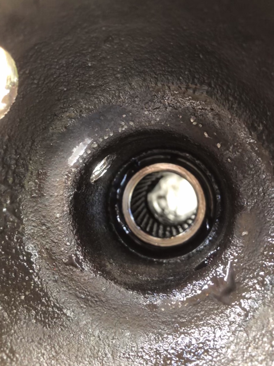

Cleaned up the driveshaft oil and grease and spied all the needles of that bearing are stuck. None turn. Seems the bearing walked into the u-joint collar.
Installed by me, following instructions, and checked to see the bearing was below the bore, knowing that. It is a press fit only and may have moved over time. Don't know, could be my fault, the rear ran quiet when put together, but now the driveshaft soft steel is running on hardened steel, maybe causing my low howl.
Anyway the driveshaft isn't shiny in the bushing area as normal with Ford soft metal bushing, so am going to replace the needle with a bronze bushing.
Maybe all these little fixes will reduce the noise. Good to look at moving parts from time to time :lol:
Latest follow-up.
The needle didn't walk at all.......so not's the needle faulty but the pinion bearing got loose.
So the u-joint walked as its pinned to the driveshaft, and there is now .020" gap on the nice pre-load I placed on the modern bearing years ago on install.
Maybe the roller bearing wore or maybe the lock collar moved, anyway time to fix.
That will get repaired as likely the cause of the whole developing low growl, let the ring mesh get loose, and let the needle get crushed, due to the movement of the driveshaft.
Will now use Lock-Tite on that locking collar instead of only relying on the set screw if that is what moved. Figuring out the noise is always a chore, but now have measured some gap that has to be taken up.

Does the needle bearing replace the front drive shaft bushing. If so you do not have a front thrust bearing for the u-joint. Big mistake. Never throw away the thrust surface. If you have a modern bearing Drive Shaft Spool never rely on the Clamp ring to keep the proper Drive Shaft end play. It lets go with time. always set end play with the front Drive Shaft thrust Bushing . You want no end play or the Ring Gear and pinion clearance will be changing. Not Good. A modern bearing Drive Shaft spool is ok but stick with Fords method of setting end play and clearance. Then it makes no difference if the clamp ring lets go.

Post by Mark Gregush » Sun Sep 22, 2019 8:07 pm
^ And rivet the U-joint to the drive shaft.

The u-joint is riveted, always have done that for sure. With any pinion set-up, Ford, or modern.
Have had good success with the modern pinion, this time it got loose for some reason. Like the modern taper and sealed bearing modern pinion set up, and will stick with it, except to be sure the lock collar stays locked.
As for the needle bearing, it is sold as replacement for the bronze bushing, but has no thrust face. So the riveted u-joint collar rode on it, since the driveshaft moved back with the gear play in the modern pinion that happened in my axle. Allowed impingement on needle bearing, crushed the outer carriage housing, some blue from heat, and twisted up and locked up the tiny needles from rotating.
Have only used a few of these needle front bearings, but don't anymore. A new Ford type bronze bushing will used and will be faced off with just a few thousands of clearance, per Ford manual.
That will help ring/pinion mesh to be maintained, if something later goes foul from my install again. ;)

Right on Dan. Ford knew what he was doing and a needle bearing here is a waste of time and money. The modern bearing Drive Shaft spool is a good idea but needs the end play insurance of the front bushing. Glen

I have only installed one of the needle bearing. No idea how it worked out, the car has never been started or driven. It is what the customer wanted so is what got used. Not something I would use. It did however get thrust washers behind the U-joint which was pined to the shaft.

Dump that needle bearing! They need to run on a hard shaft, and drive shafts are way too soft. the only reason it has not destroyed the shaft surface is there is really no lateral load at that end of the drive shaft. Another case of a really poorly designed "improvement".

You know, Dan, the first picture of the needle bearing LOOKED to me like the needles were skewed and I thought it was the picture/angle and was not willing to jump in with what could just have been a WAG. It is a good thing that you don't accept that "all Model T's make noise". I've heard that frequently lately and sometimes it is followed by serious mechanical destruction, and hope that those who are inclined to give that advice think harder and give more thought to it, before simply dismissing a noise as routine.
