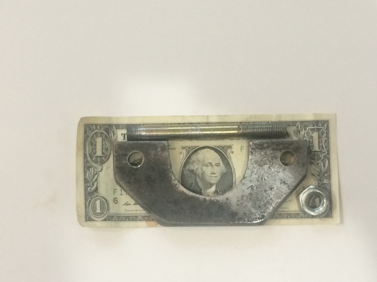

Two bolts two nuts and some scrap iron.
What does it make?
What does it make?

Steering wheel puller.

Crankshaft timing gear removal/installation jig.

How about a “sanity saver”.

Dean,
How about a scale or some measurements?

Scale

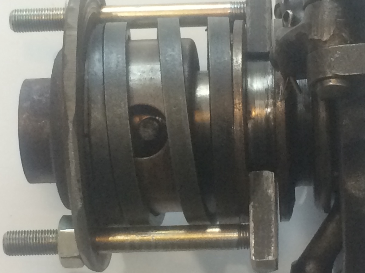

Clutch spring compressor

My pencil plans if you want to make one

Re: Scrap iron
Nice work...K.R.Yoder !
- Posts: 4694
Re: Scrap iron
Looks like a very good idea.
- Posts: 7392
Re: Scrap iron
Another version uses scrap hub plates.

Steve that is what inspired mine . Can’t remember where I put it. Mom said getting old isn’t for sissies!

Re: Scrap iron
Certain things are needed ! Thanks for sharing, both look like they would work well.

Re: Scrap iron
Nice work Dean, but I think Steve wins the award for less time spend! LOL
