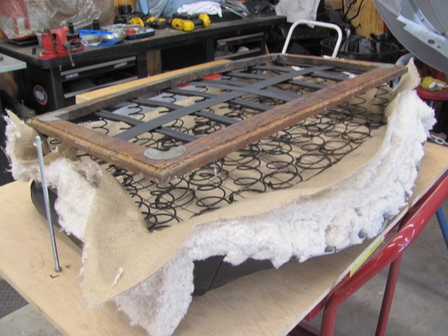

I received the new seat bottom and back springs from Lang’s yesterday. They are made by Snyder’s. I’ll pick up the seat kit from Classtique when I’m at Hershey on the Thursday of the show. The new seat spring set is framed with aluminum. I’m assuming that the original frame is steel. Is there any compromise in strength by using aluminum in the new set? I’m 230-ish pounds and hope it holds without distortion. Was thinking about transferring the new coil springs to the old frame, but maybe I’m worried about nothing. Mike at Classtique did ask if I wanted to use hog clips or channel for installation. Which is better? Also, I can see through the holes in my old upholstery that there seem to be some type of sheet metal band inside the sides between the upholstery and the body. Is this a spacer to keep the upholstery from resting against the sheet metal? I haven’t seen any mention of these in older posts.

I would use 3/4" plywood for the compressor. It takes a lot of pressure to compress those springs. For the bottom I used two one by fours. I don't know why, but Langs and Snyders both sell Mac's upholstery kits. I would stay away from them. Mike at Classtique does a much better job. I sewed a piece of plastic welt around the skirt of the seat spring upholstery to hold it in place after the channel is compressed. I used wide jaw vise grips for the channel.

Post by DanTreace » Tue Oct 01, 2019 11:32 am
Mark
All the covers for the later T's used with me have had the beading in the edge that fits into the channel as Larry mentioned, use a channel lock pliers to fold over and close the channel, stock Ford method.
The channel makes for a very neat appearance and more practical as the spring base sits best in the seat frame with stock method.
Hog rings are modern and weren't used on the Ford, but can be used. In this case I preserved the new spring cushion by using hog rings, as the cover was only a blanket, for simple job. Easy to remove the hog rings and then this new spring base could be done later with correct channel install of the right cover.
The compressor is needed to do this work on seat springs, this one is non-Ford, but operation is the same, layout the cover, place spring over, the compress the spring, and fasten the upholstery covering.

Post by Mark Osterman » Tue Oct 01, 2019 2:38 pm
Thanks so much! Those pictures are just what I need. I did speak to Mike at Classtique yesterday about the installation and picking up my seat kit at Hershey. Also spoke with him about how helpful it would be for them to create installation videos shot professionally without an audience so there is a free view to see both the whole scene and close ups as needed.

Post by Original Smith » Wed Oct 02, 2019 11:27 am
When I did mine, the plywood compressor I used was about four inches all the way around bigger than the seat spring. I used two 2X4's for the bottom somewhat close to the edges of the spring to distribute the force more evenly.
