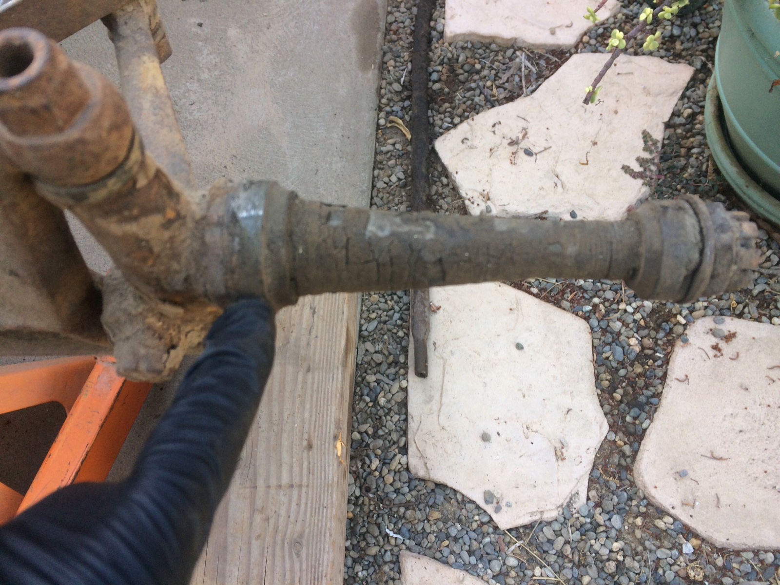

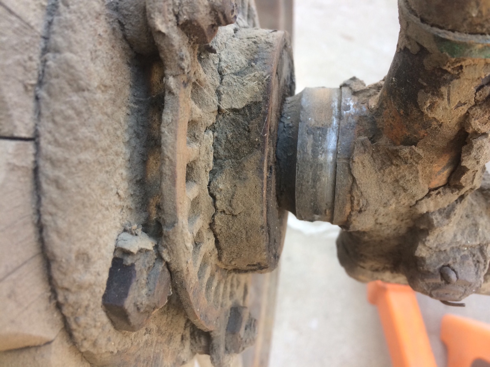

Inner bearing race pressed on spindle?
Is this normal?
Thanks!
Matt
Matt
Ruxstel24
- Posts: 2383
- Last Name: Hanlon
- Location: NE Ohio
Re: Inner bearing race pressed on spindle?
No...
Maybe you will need a little heat to get it off, but it should slide off.
You might be looking for another spindle
- Posts: 4628
Clean up the spindle with diesel or some type of degreaser then you may have to heat up the bearing that’s stuck on the spindle. It should come off. Use a drift or something to tap it off. The spindle may still be good hopefully. Then you will know for sure if the spindle is still good.
Good luck!

- Posts: 5474
That's common on the early, full circle spindle bodies - a little cleaning, soaking then heat will get it off. Notice that it doesn't have the later double sides flats to assist in removing a stubborn race, which is a good thing !

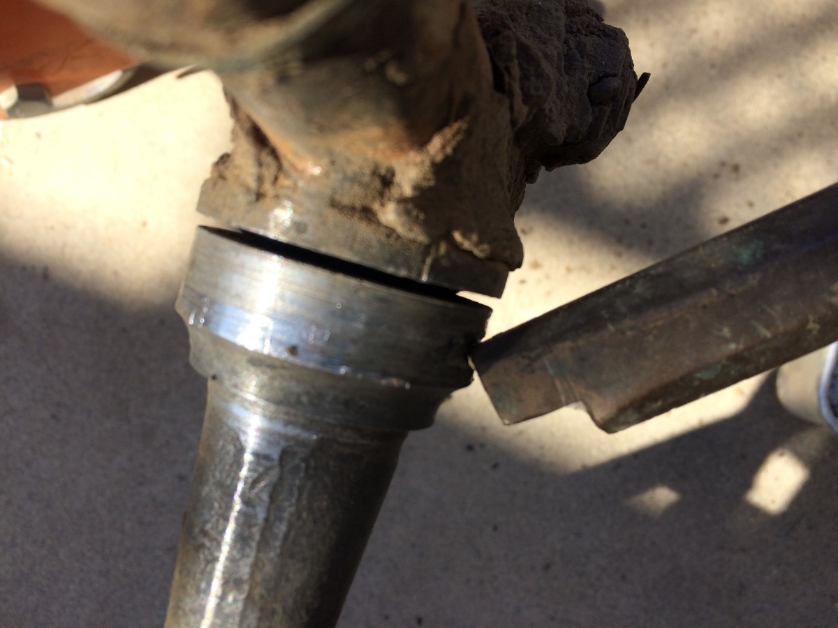

Thanks for everyone’s input!
This is what I did:
Heat source- angle grinder. Large monkey wrench was then able to move it... But that didn’t help in getting it off. But I found the flat spots that Steve mentioned. The other spindle did not have flat sides, so it must be an earlier one. I made a notch with the angle grinder. I am using this axle for rollers wheels, not a running car. The funny part was I found that my second old wheel had ball bearings. So I put one bearing race back on. I put light oil on it dirt cleaned off and it slid right on. So dirt must have caused it to bind up.
Thanks for everyone’s help.
Matt
This is what I did:
Matt

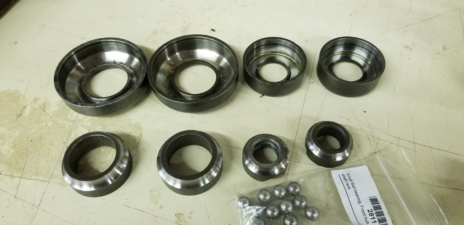

This is one of those days I wish I could go back in bed before I got up this morning! Not to mention I ruined the two inner races, I’m feeling like I’m coming down with a cold.James_Lyons-WV wrote: ↑Sat Oct 05, 2019 10:51 pmMatt... I get $275 for a set when I provide the cores.
I hope this will help someone. That is as education of what NOT to do. But unfortunately they may read the statement after they follow my procedure up above!
Matt

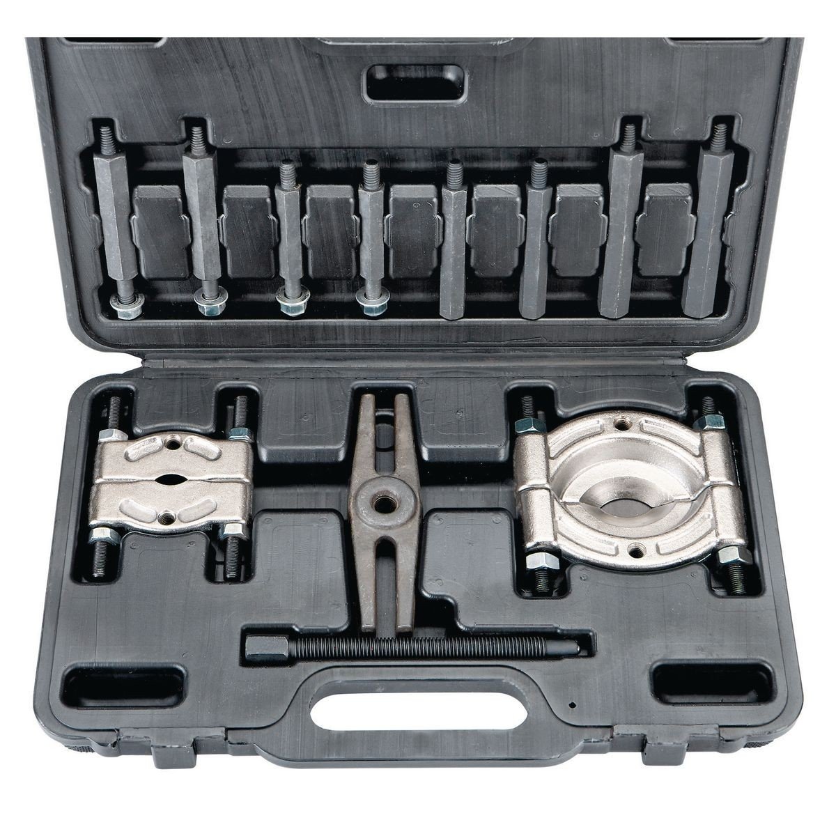

Has anybody had any luck getting those inner races off with one of these?
Ruxstel24
- Posts: 2383
- Last Name: Hanlon
- Location: NE Ohio
Rodger, not sure that would help, nothing really to grab on to and usually heat will do the trick.
Matt, don’t feel so bad, the second set of pics shows the bearing surface of the race was pretty badly pitted...I wouldn’t use it.
