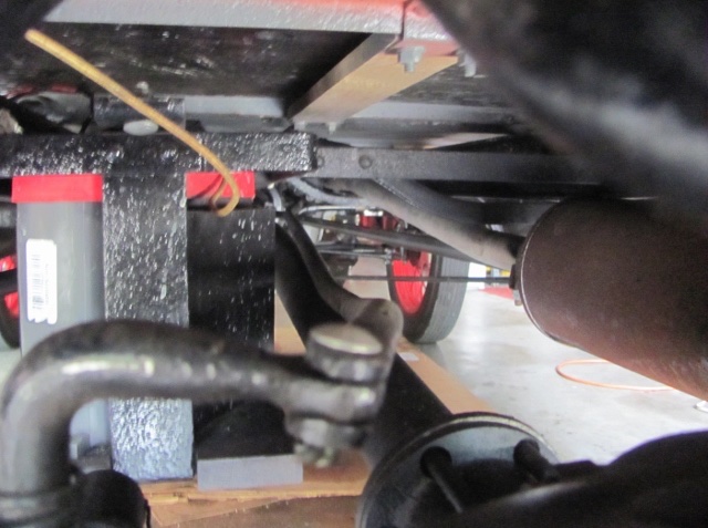

Believe your question is what position is the little arm on the shift lock assembly for putting the Ruckstell into gear? Since you don't have the linkage rod or the hand lever at the u-joint mount.
The little shift lock 'arm' on the Ruckstell when in full rear ward position, to the rear of the axle, keeps the differential in standard Ford gearing or 'high'. When the little shift lock 'arm' is pulled forward, toward the front, the Ruckstell is now engaged and puts the differential into Ruckstell gearing or 'low'.

So basically it is an on-off lever. Either you are in Ruckstell or you are not? Is that correct?
Thank you for the picture Dan.
