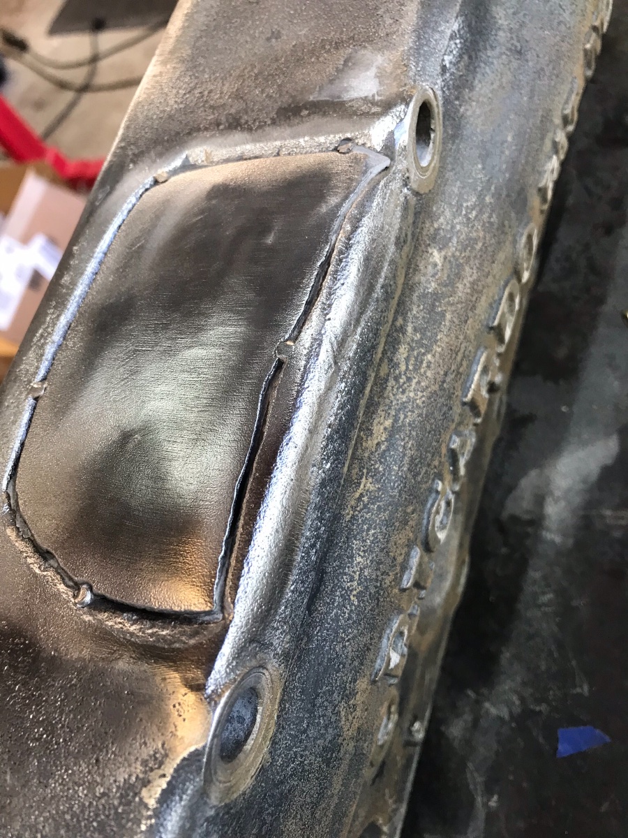

. .and then after soaking my Ricardo head in Zepp solvent for 4 days, I uncover this amazing "Fix". There's some work to do for sure... it took some time to uncover it and clean all the epoxy away, but I now know why this head was leaking in a mysterious way... I see some silver braising to fix this in my future. I found this product that looks interesting
