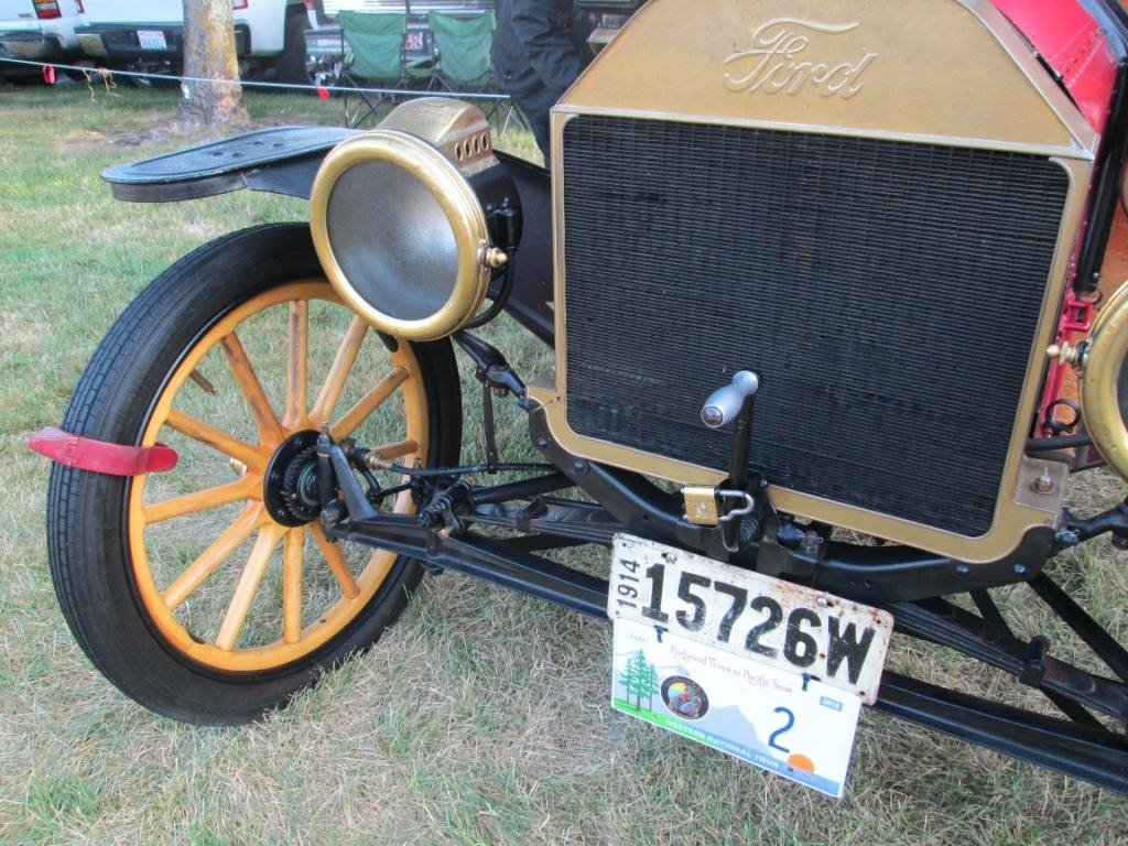

Post by Steve Jelf » Mon Oct 14, 2019 10:22 am
Frank in crank-up mode.
Seamus has this upright-crank accessory on his 1914.

Steve, Seamus accessory is a bit hard to see. it is interesting indeed!
Seamus accesory crank holder.
TH

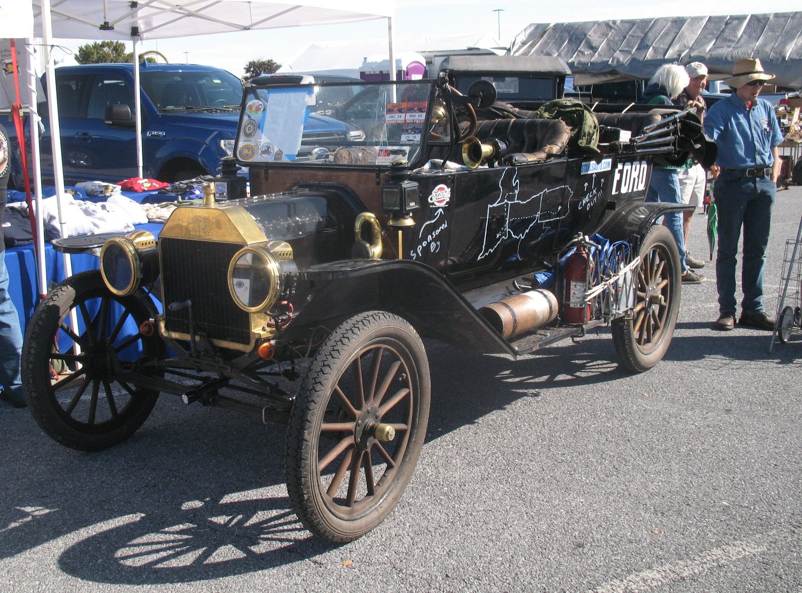

Post by RajoRacer » Mon Oct 14, 2019 4:32 pm
Here's a later model stamped steel "OAKES" Krank-Loc on our '14 - I believe the early ones were cast.
