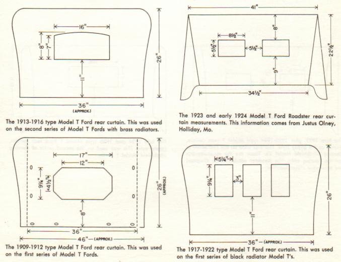

I'm collecting data for rear windows for 1913-1927 tourings and roadsters. I'm only interested in cars that have the original tops supplied by Ford. I need the size of the window, (light), and the spacing between the windows from 17-21, and 22-24. For the purists out there, if you have ever been anywhere where there is a group of Model T's, it's almost disgusting to see the variations of T's with the incorrect placement of windows. I would like to help change that.

Post by KWTownsend » Sat Oct 19, 2019 6:52 pm
This is form Les Henry's book, Model T Ford Restoration Handbook.
I'm not sure where this one is from...
Note there are some differences between the two, as I'm sure that there was differences in production as well depending upon supplier, especially in the early years.
Keith

Post by Original Smith » Sun Oct 20, 2019 9:49 am
The illustrations above are exactly why I posted this. There can't be two different sizes for the years posted, there can only be one! I'm working with Mike Francis on this, and we will eventually clear up all this misinformation.

Re: Rear Windows
Post by Humblej » Sun Oct 20, 2019 12:34 pm
Ford factory drawings at benson ford research center would answer that. There may very well be different dimensions for the same style windows. My experience with factory drawings is that there were many subtle changes for some parts even during a 12 month period, even for a short run style such as the 26-27 models. It may turn out that for some window styles there was a change every couple of months, so the quintessential, all or nothing, black or white, right or wrong, single configuration for show judging standards correct, does not exist. Who knows where Les Henry got his dimensions from as well as other pearls of wisdome for his book, but 40 years ago his book was THE source and that was what we looked at as the authority.
