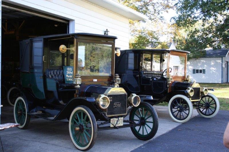

Hello Frank:
Glad to oblige. The accompanying car in the foreground is Jim Finney's fabulous 1912 original. Town Cars don't come anymore rare that this one. Jim allowed me to measure and photograph this car which resulted in mine. Not shown is Jim's original coach interior with windows shades, jump seats, and embroidered fabric trim. The color scheme has been changed over the decades, but was very tastefully done by the late Paul Antonucci. Truly a sight to see.
Regards,
Scott

Post by Sarikatime » Wed Oct 23, 2019 9:19 pm
Scott, thank you for the beautiful picture of your and Jim’s towncar. I am absolutely druwling on my iPad looking at those beauties. You know I took all your advices and tried to make mine as beautiful as yours. I see Jim’s roof trim is exactly as you told me to make mine. I am working on that. Thank you!!!!!!! ( I don’t know how to spell salivating, sorry)
