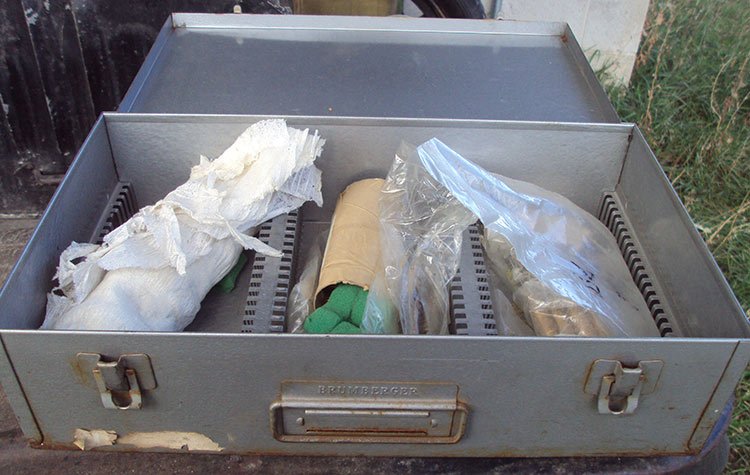

Re: Motometer thermo replacement part
Back in the 70s our local A&T dealer found this at a swap meet. I wish I knew where they came from or how to install them. At least they were available at some point in time.
FWIW
FWIW
