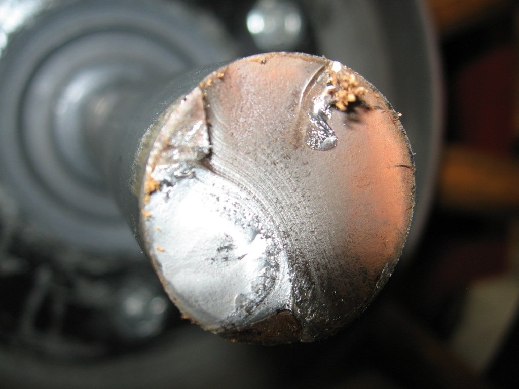

Just be careful not to let the spring steel fingers rub on the axle shaft, or eventually they will wear a groove that acts as a place for cracks to start. I found out the hard way.

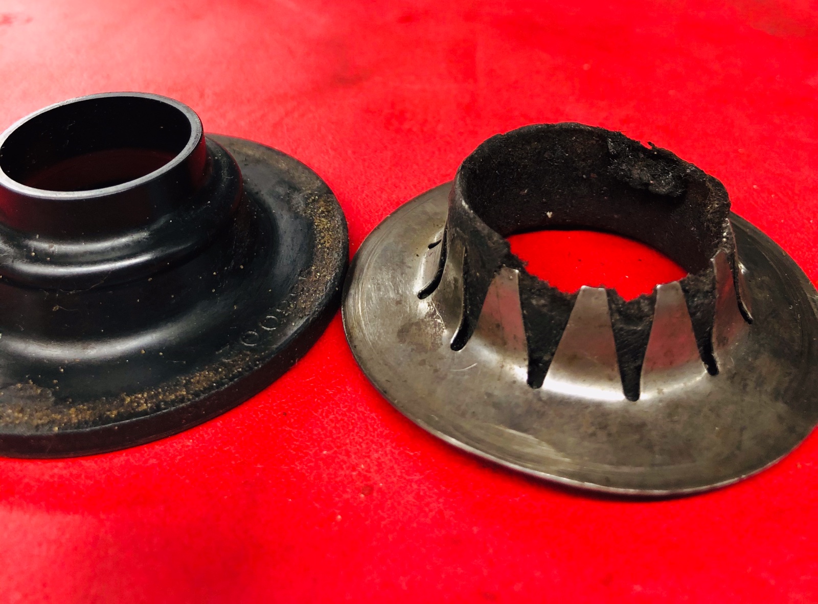

Would agree with Mark. While haven't experienced a fractured axle from the spring toothed washer of the Ford leather rear axle seal, still prefer the much better modern rubber seals from Chaffin's with the long flexible nose.
Ford didn't add that hardened spring toothed washer until the last, had the leather boot in place, but only came out with that washer in the last year, June of 1926. Don't think Ford thought that washer though, they did know the leather warped and allowed seepage, so did add that spring washer to try to hold the leather nose around the axle.
Note the new 'washer' added as part # 2511B for the #2511 leather.
Leather washer Ser Bull.jpg (119.32 KiB) Viewed 5119 times
The better IMO is the modern rubber, long flexible nose, these work fine for my T's.
As for the hardened spring toothed washer of the Ford design, note this one on the right. Pulled from rear end, and the leather boot is almost worn gone, and you can clearly see how the hardened teeth of the Ford late design can rub and wreck a good axle shaft. :(
Improved leather type seals were already in the aftermarket, this one is patented with coil springs, better idea than Ford, if the coil got loose only would run in circles around that spinning axle. ;)

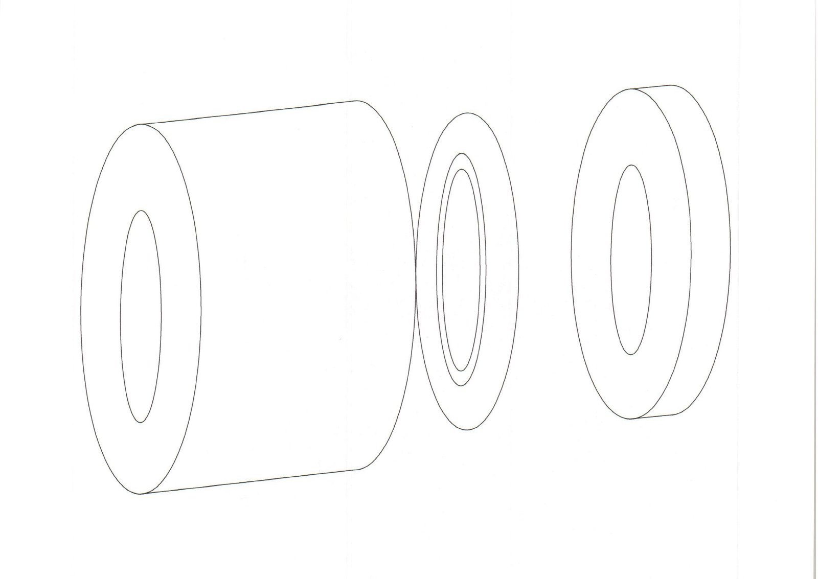

Hi Guys, I have thought about this some for a while. I have been installing a bearing/seal setup on most of my model T's. It works well with a modern bearing and seal. I would also like to see a free floating seal that could be used with stock bearings. The modern seals for this don't float and can't follow the axle. Our Model T's have some movement that was built in. Here is a sketch of what I had in mind. It would use a stock seal retainer with a floating seal and retainer pushed inside before installation. This setup only requires one seal at the wheels and now all the bearings can run in the rear axle oil, like a modern car.

John
there exists a free floating seal...Dan has one pictured on the left side of his picture. It works very well.
regarding seals at the outer end, you are right...the axle flexes enough that they always get beat to death and become useless. So long as differential oil is kept out of the grease (and the seal Dan shows does just that), the grease stays put with FORD's felt seals just fine anyway.
I believe that Chaffin's makes/markets the seal. It's excellent.
