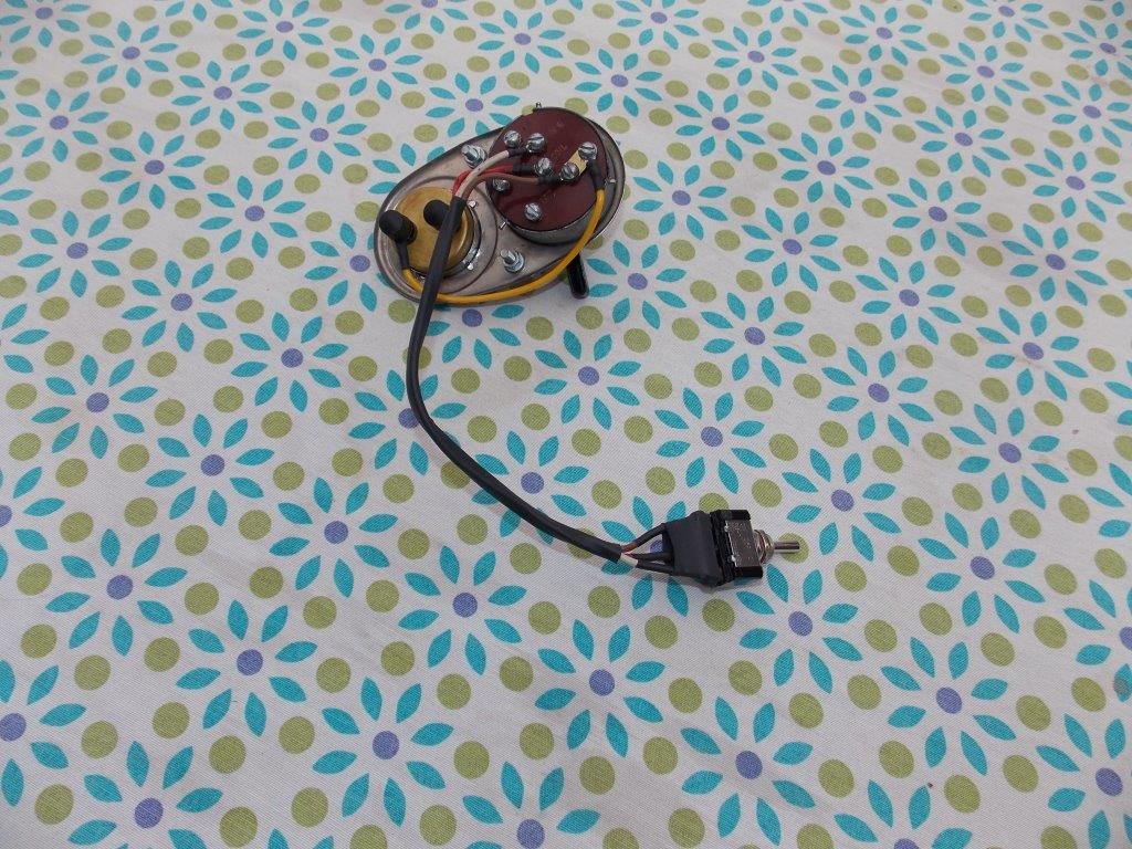

Think may have an ignition switch problem causing my mag problem. If I have the switch out of the system , is there a ez test to see if this is my problem. Truck runs pretty good on battery. Thanks for any help/    Eck

If you're suspecting an intermittent problem in your switch, it's pretty easy to wire up a 3 position toggle switch on your steering column and run it that way for a while to see if the issue disappears. The switch would be termed " On-Off-On". The center lug gets wired to the coil box, and each outer lug would go one to the mag post and the other to a battery source.

Thank you very good idea. I will pick up a switch tomorrow and give it a try    Thanks again    Eck

Here is what I did in the past.
For me, there was a short in the switch. During a ride, when I canged from battery to magneto, there was DC current connected to the magneto and the magnets discharged.
At the last I run the car with only with the three way switch and that for a few years now. I disconnected the wires for the ignition from the original switch and connected it all to the three way switch. no problem since than.
Good luck
Andre
Belgium
Good luck
Andre
Belgium

William,
Having wasted a week or two after rewiring a truck and pulling what hair I have left out, the only thing that I
didn't check was the switch like you have. Low and behold it was the switch that was causing all the problem.
I was told that Mr. Ben Martin in Georgia was the absolute best at reworking the entire switch to better that
new. Made contact with him, sent the pin back switch and face plate to him for an overhaul. Just received it
back the other day. It is absolutely beautiful inside and out. He had the faceplate powder coated to perfection.
Installed it and all the problems are gone. He truly is a craftsman that of which is so very rare today and a true
gentlemen too. Have him go through your switch to eliminate any present or future chances. If you need his
phone number it should be in the suppliers section or just shoot me an email and I'll respond with it.
