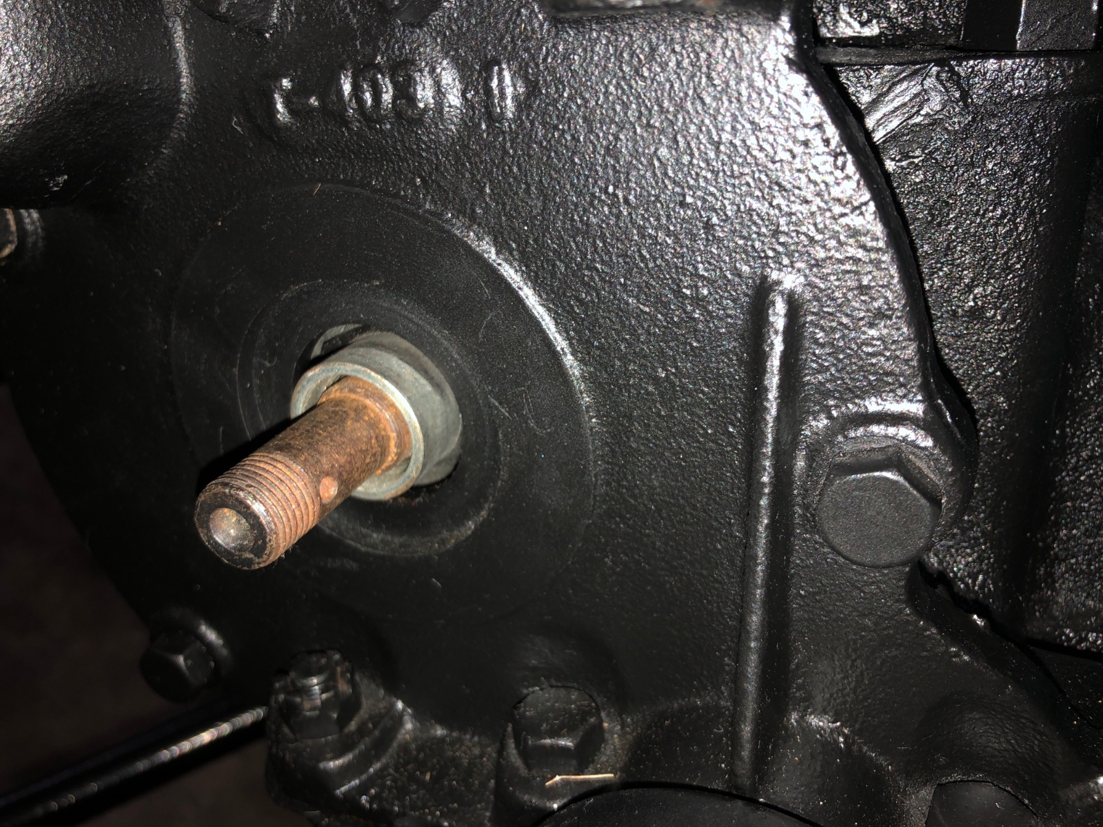

I have had two knowledgeable guys try to explain the order of assembly of the timer felt seal and timer on my 11 Touring but I just don’t get it. One said the felt seal goes behind the timer between the timer and timing gear cover, the other said the felt goes inside the timer body between the timer and roller. This timer came with my car, I bought the felt and shield from a supplier. The felt seems too thick and the hole in it too small. The shield hole also is too small. With either of them installed they push the roller out beyond the hole for the pin. Can someone clarify the assembly or post some pictures? Thanks, Art

Here is a picture of where the hole is without the shield or felt. Art

You have the wrong felt seal and shield. Those are for the later timer

If you don't already have it, you should obtain for yourself a copy of the McCalley Comprehensive Encyclopedia CD that has all the parts and drawing lists. The correct felt is called out as:
T-474 3213 1909-12 1909-11 1909-11 Commutator oil seal. 2" o.d., 1-1/4" i.d., 3/16" thick felt
If you look at those dimensions, you'll see that it fits right inside the counterbore of your front cover with just enough thickness for compression.

I ended up slicing the felt in half and put the timer body on, then the felt, then the shield( made one out if thin brass) then the roller, pin retainer and thin locknut from Langs. It looks like the VowellArt drawing of the 11 two piece timer but with the shield after the felt. Art

That may be how that non-factory drawing was made but that's not how it was originally. Let us know how that works out for you in service.
