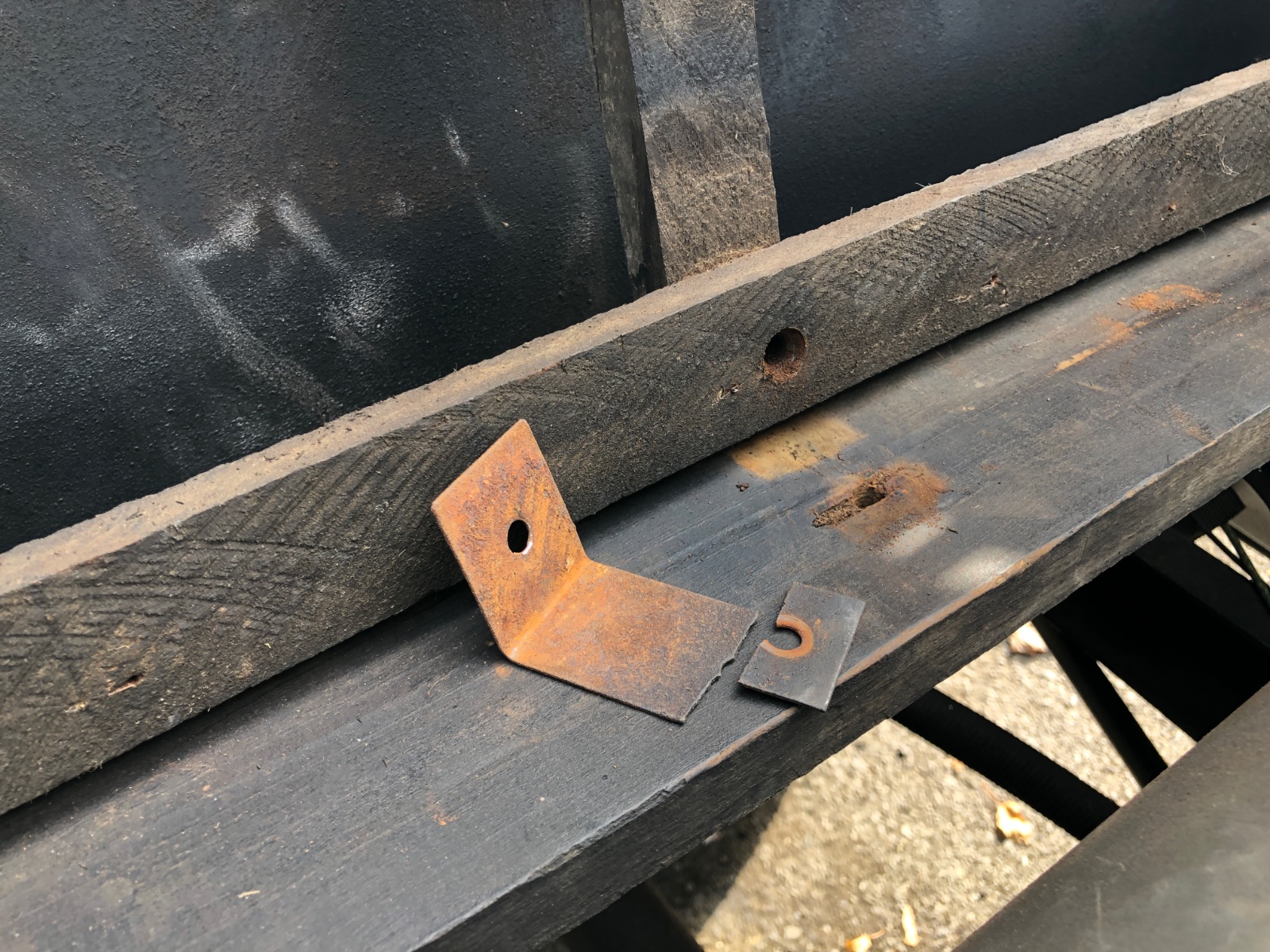

Made some headway with the seat upholstery today. Had a few things to fix once I got in there. Installed the new back springs, covered them with canvas and cotton wadding and started to tack the cover material along the bottom tack strip. Seems impossible to get my pneumatic tacking gun in there. Guess I need to use the old spring type.
