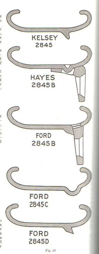

When tight do the 4 rim lugs have a gap from the wheel or do they contact it ? I do not want to over tighten.

if the rims have welded permanent lugs and are matched to the correct felloes, my experience has been that they leave a small gap when properly installed.
If you have removable lugs that fit into a notch on the felloe, those get tightened completely down, but I suspect that this is not the style you're asking about.

John,Scott is right about the fixed lug rims. Unless the rim/ felloe have been left loose and have worn, there should be a gap. However, loose lugs also should stand off the felloe, each foot of the lug registering on the rim and felloe nothing, with the flat between them not touching the felloe.

With demountable rims it is not uncommon to have a mismatch between rim and wheel. There was at least four makers of wheels and rims and they are easily mismatched. I have Chevrolet wheels on Ford rims, from six feet away you can't tell but they do not fit perfect.

David, did you mean Chev rims on Ford wheels? Chev rims are easily picked, the lug nearest the valve stem being slotted. Chev rims are wider than T rims, and this means that the lugs will stand further off the felloe than a T rim, as the rims bind on the inside edge of the felloe.

actually, the rims should fit hard against the back (flared) flange of the felloe. If the luts sock down tight to the face of the felloe, this means it's the wrong rim (or at least an incompatible rim), or the felloe has rolled by itself on hard ground and flattened out some. I have seen wheels where the lugs were socked down hard and those bolts were the only thing "suspending" the rim in the felloe. The unsupported rim flexed enough that at slow speed it felt like the wheels were square and at speed would really lope along. And while many brand rims seem to fit various felloes, it pays to do a MTFCA google search like Mark G said, and find out what you really have, assess their condition, then keep what matches and work to get proper mates for those that don't.

Scott, I believe you are correct in saying that the rims should wedge against the inside ledge on the felloe, and the wheel bolts just maintain that wedging effect, but I also believe that this is true only for welded lug rims, which have a wider rolled edge on the inside of the felloe.
Kelsey loose lug rims wedge on the outside rolled edge of the felloe. Kelsey felloes have rolled inner and outer edges of the same width.
With welded lug rims on correct undamaged felloes, the inside of the rim wedges on the inside felloe edge, and it is possible to insert a credit card between the rim and felloe on the outside.
With Kelsey loose lug rims, the rim wedges on the outside felloe ledge, and the credit card can be inserted between the rim and the felloe on the inside.
The two felloe types are of different diameters, as indicated by the need for different lengthss spokes needed to rebuild the wheels.
If rims/wheels are intermixed, this wedging effect must be part of the fit. Any combination which achieves the wedge and does not rely on just the 4 bolts should be satisfactory. In any case Hayes rims are the least likely to fit because of the need for a relief in the felloe needed for the foot on the lug. Which brings me to Chev rims, invariably made by Hayes. These are wider than T rims by 3/16" to 1/4". When the valve stem hole is drilled to suit Hayes made Ford wheels, they will bolt up to fixed lug type felloes, will wedge on the inner rolled edge on the felloe, but the lugs will stand further off the outside of the felloe, reflecting the fact that the rims are wider.
