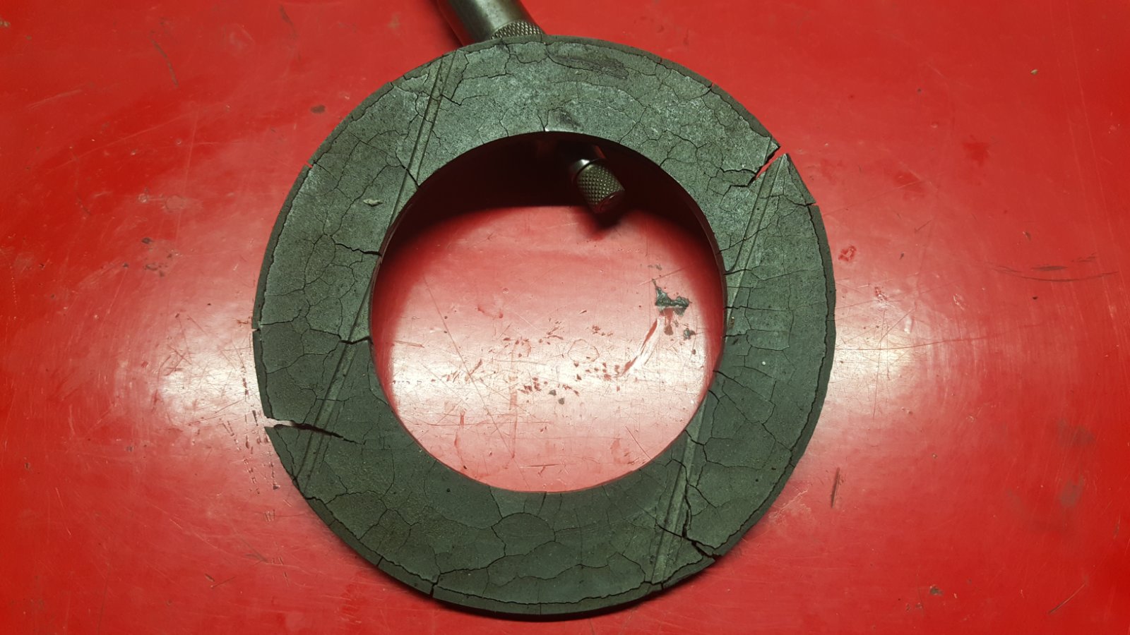

This fall I disassembled and inspected the differential in my 1913 Runabout. This thrust washer was the good one, the other was in very fine crumbs all over inside. I am now a member of the “Loyal Order of the Babbitt”. Oh, well, at least I am not yet a member of the two piece crankshaft club!

Post by Walter Higgins » Thu Nov 07, 2019 2:42 pm
It's one small sneeze away from crumbling:
