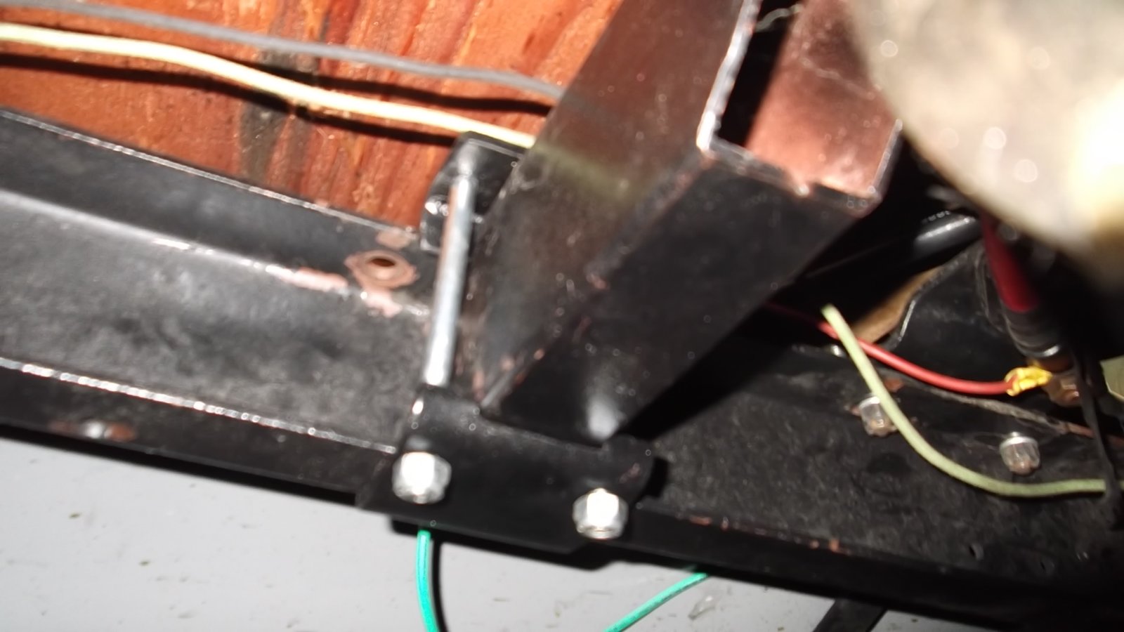

Some quick photos of how I mounted my cast iron Warford. It was painted silver when I got it so repainted same color.
From the front, notched for exhaust pipe.
I notched the cross bar and used wood filler in it to add strength and fill the void, this way the metal cross channel is not rubbing top of case.
Shots of L brackets at the ends
You will note the hole just above the Warford case. I at first got it backwards and had to redrill from the other side. There needs to be a place for the shift rail to go into in the cross channel for one of the two. The original Warford support had this.
I am going to ask a real to the point question, is it a cast iron 3 speed Warford or are you using Warford as a general term? Kinda like some people calling ALL outside brakes Rocky Mountain.
