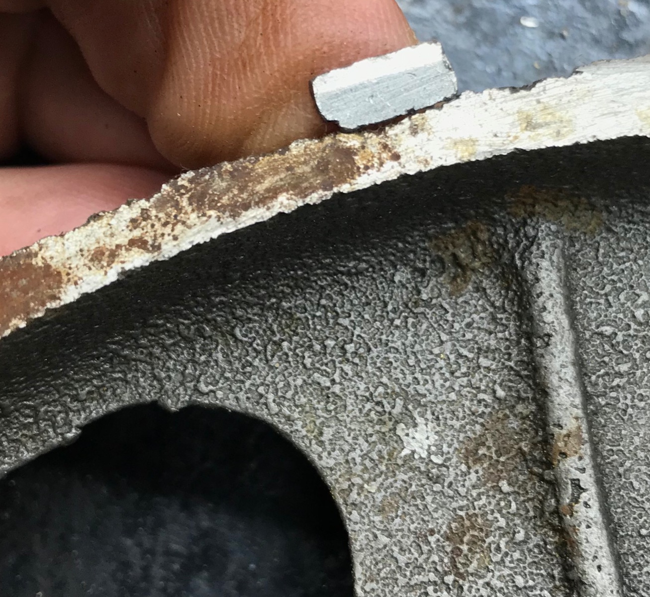

I've put a couple hundred miles on the new T motor so I changed the oil today and found these 3 little bits in the drain plug. They are all 0.036" thick, and magnetic, so it's not Babbitt. Any ideas? Other than that, it looked great.

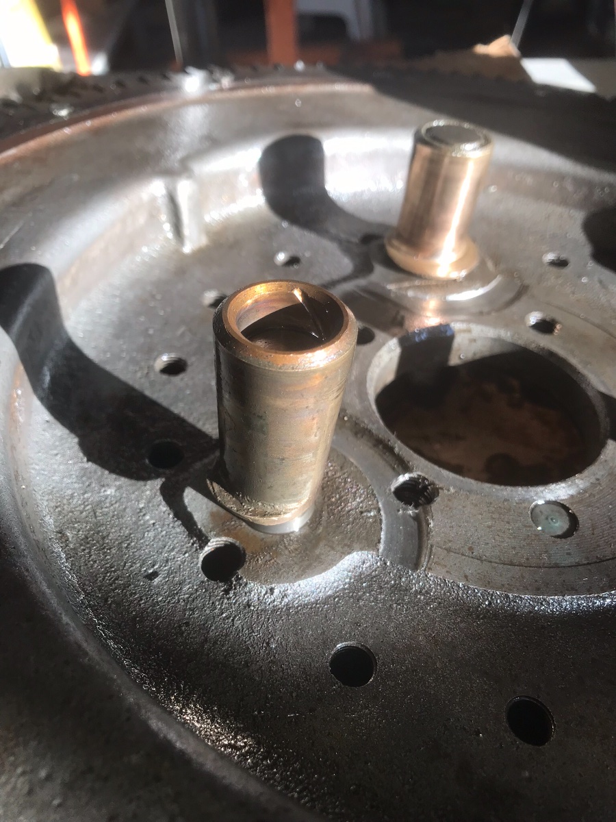

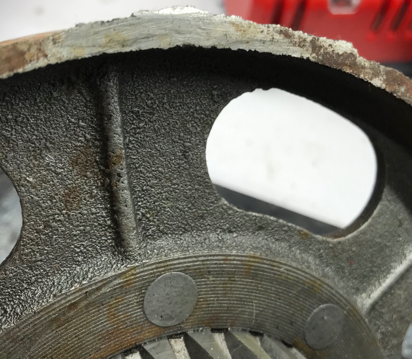

When the last failure happened it was epic. The triple gear bushings were so far gone that the gears were tilting into the reverse drum. That eventually ground the lip on that drum to 36 thou which turns out to be the magic snapping point for the whole lip, which then ended up in the bottom of the pan, and some lodged in the recesses of the oil drain area. My vigorous cleaning didn’t get those three bits out. They are also cast iron as they break apart when i took a pair of pliers to them.

You did replace that drum, didn't you?
AdminJeff
Re: Mystery solved! Found these in the oil change today
Hank, No kidding! Let this be a lesson on really cleaning those nether regions for all of us.
And Steve, now that I'm a model T owner I'm a cheapo. So, After I welded the surface cracks I took a file and resurfaced that drum. It's good as new. I reused the triple gear pins too.
- Posts: 7386
Uh-oh. Good luck with that drum. I had a reverse drum with a damaged lip. I ground that smooth and figured it would be OK. Nope.

Last spring before going on the Florida tour and had a broken tooth from metal fatigue on a triple gear. I made the Florida tour without any trouble because of no hills. When I got home replaced thansmission. If your triple gears were that worn I would have replaced them. It is to much work to do over later. Good luck. Clyde

Clyde, Up to the point that one of the triple gear teeth actually broke, amazingly the car drove pretty well, and nobody could tell me what the rattle can noise was when going downhill (failing triple gear bushings). "Model T's just rattle" I kept hearing.

I also used the needle bearing triple gear setup from Dan McEachern. He also gave me the prize for the most extreme wear he's ever seen on triple gear bushings. Kinda like getting the "client of the year" award from your lawyers office. Not a moniker to covet...
