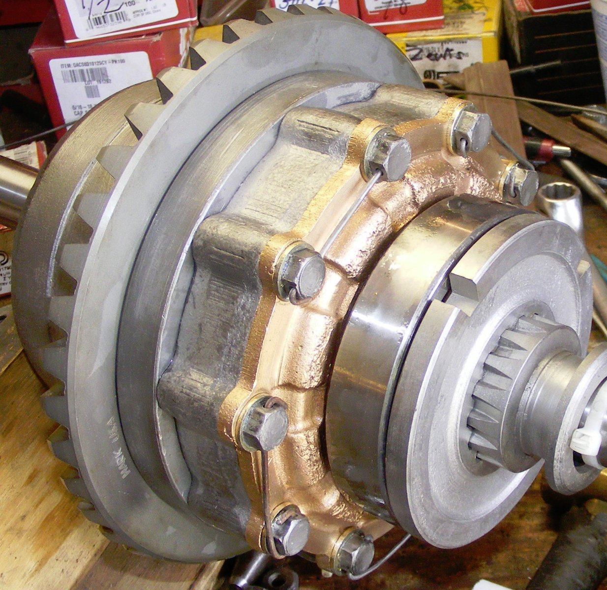

This whole unit fits into the case and the notch plate locks in with two screws. One that also holds the shift lock on and another short one on the top of the housing.
If the bearing has stuck and worn the boss that the shift plate fits into, which it can do if the lock bolts are not holding the plate, the plate can turn and wear into the case. Putting a shim behind it -- such as the piece you have here -- would move the entire unit back to at least a somewhat correct position, cause the lock plate to be in position to hold when the lock screws are tightened against it and move the ring gear against the pinion gear so it would work.
These things were abused beyond belief. Parts were not available. Repairers and restorers did what they thought would work and did what the had to do to get things back working.
I can see no other use for that washer but as always, I could be wrong.
