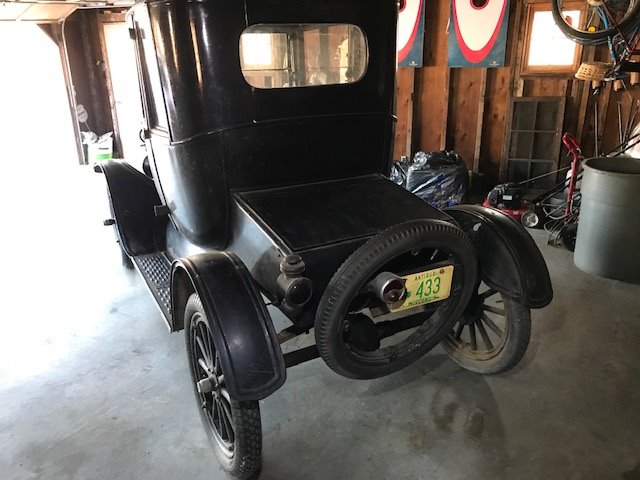

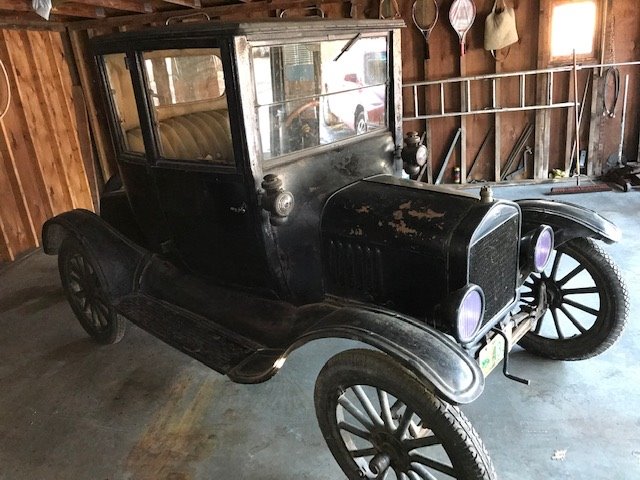

Am asking knowledgeable T'ers if this is a 1919. Will post a total of 8 pictures. All comments appreciated and valued. Thank you.

The T type handles started with the 1921 model and as this has exposed wood around the window area so I would say 1921 or 1922. If the wood is good looks like a good start. Except for glass and making safe to drive, I would not change anything from what it is now, that is a great looking survivor. Ok it may have had a repaint at some point(?), but non the less :mrgreen:
I see that it has the old style front spring mount and crank. I would have to check but think both were changed in 20 or 21. What does the engine number put it at?

I am not sure about the engine/spring brackets, but the hand crank is the later type, beginning in 1920. Oil side lamps I think were added at some time, I don't think that particular bracket was used by the factory for the earlier coupes. I think I can see the cross brace for the earlier forged running board brackets. That would likely be the most important detail to check again to see if it is earlier or later. I think 1920 was the crossover year when both types of running board brackets were used.

"We wish to call your attention to the new style pressed steel running board brackets which has gone into production and as shipments have been made to some of the branches we ask that you kindly note the changes which will go into effect through the adoption of this new bracket." (A list of parts followed.)
I see the cross brace too Wayne. :)

A bit hard to tell with what photo's we have to work with but I'm going to say at some time in it's life it's scored a 26/7 engine, besides the fan water outlet mount, it looks like top bolts on the hogs head as well.

Yes, the fan setup is 26-27. If we could see the pedals I expect they would say 26-27 too, as the transmission is often replaced along with the engine. The rest of the car may well be a 1919 or thereabouts. The presence of a water pump suggests the car may need a new radiator.

This is a good survivor that probably will need a new radiator. Looks like a honeycomb radiator but won’t know for sure about cooling until it’s started up and driven for a while.
For now I would clean it up, see how runs and drive it. If you want the correct engine for the era you can do that later.
Several years ago this car would probably be taken apart and “restored”. If the wood is still good leave as is. It’s to good to be turned into a trailer queen and just looked at in a car show.

A little bit of "parts salad" to this one. The starting crank goes with the late model engine. The steering wheel is earlier than '19. Perhaps the earlier stirrup handles got replaced for tee handles ? I had a '20 with forged runningboard braces, certainly a '19 would have them. What a great car !!
I can't get too worked up about a later power plant swap in an early car, especially if it was done during its using life. It would have been the thing to do to keep it on the road.
