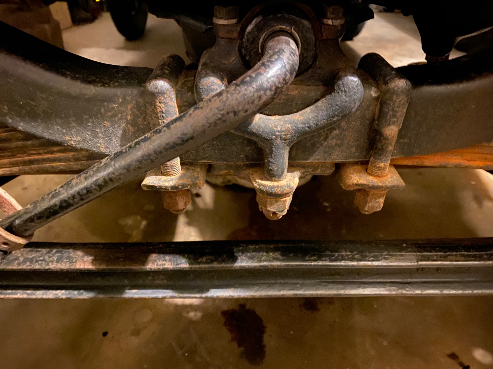

I'm about to replace the front spring, perches, shackles, etc on my 24 Touring and am wondering about this spring clip configuration on the car and whether it is stock.

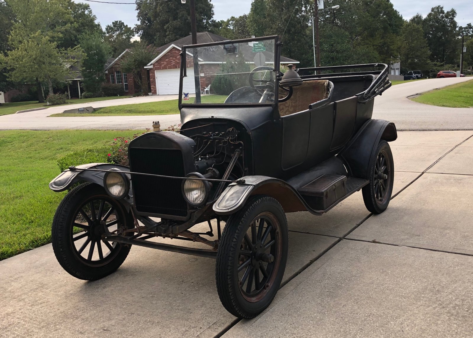

All the forensic evidence points to this car as having been revived during WW2. What I believe they did was take a pretty much rust-free, thoroughly orginal (paint and all) 24 T Touring that had been wrecked (and recieved sheet metal damage on one side in the front as well as the radiator) and repaired it with either junkyard T parts or parts they had laying around from other T's.
Having been raised on and around farms, I recognize this sort of "look" as coming from a car/truck/tractor that has seen hard use but has always been stored inside. It's a unique look, but I've seen it several times over the years.
My question is about the front spring clip. I see that there's one in the middle that I've seen on the improved cars, then two outer ones that I've seen on earlier cars. Whatever was done here, was done a very long time ago, possibly at the same time all the other repairs were made.
I'm not restoring this car but rather returning it to the time in WW2 after all the repairs were made. So...if the current spring clip configuration isn't stock, but would still work well, I'll just replace the springs and put it back like it is.

Here’s another, higher resolution photo.
The two outer ones sort of look like rear spring clips.

Yes, your car is wearing some extra parts.

I wonder what their logic was.
Do you think the extra two could be to keep the car from leaning so much when they had it loaded down?
Maybe I'll get the springs out and discover that one of them is broken and they were using the other two clips to patch that problem.

The earlier T’s used a one piece wider bracket to clip the front spring to the front cross member. Maybe that’s why the 2 extra clamps were added to add more substantial bracing in their mind like the earlier ones were.
If that’s what was on their mind maybe they couldn’t find the earlier wider spring bracket and added the 2 extra ones to “make” one. After all the 2 are interchangeable.

It rides better with the single bracket, but given what I think you're doing with this car, it is an interesting oddity. When you get to it, you may a broken leaf or two and that may be the reason for the extra clamps.

An early taper leaf front spring also. It naturally belongs on a 1916 or earlier T, but as another piece of the car's history, maybe a taper leaf spring should still be there? It may be that whoever added the extra clamps was trying to compensate for the lighter spring?
There were six-hole castings sold after-market that were made to use both the '20 to '27 engine/spring mount and U-bolts in a similar fashion. They were supposed to stiffen and strengthen the front suspension (frankly they didn't really help that much), and mostly used on trucks of some sort. But that does not look like what you have.

If you removed the 2 extra clamps you would have the original set up for your car. The one in the center. The earlier and wider set up that Steve Jeff posted was used up to early 22 but maybe earlier. Others would know for sure. Someone added the extra clamps to make it a little better in their mind.

The parts book lists the 3075 front bearing & spring clip assembly for 1921-1927. The 3810 spring clip bar that goes on the bottom to hold the spring is also 1921-1927, of course. Parts books will often answer questions like this.

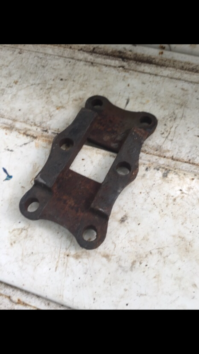

i think I read that is to prevent the front crossmember from cracking because the newer spring mounting is too flexible and it makes a stress point. I found this one on a chassis I bought years ago.
