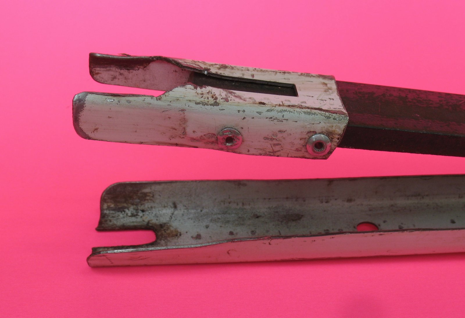

Anybody got a homemade valve spring compressor that works well on Ts? 'Specially one that will work on an engine with the manifolds still on. Let' see it, please.
Or, recommend a good "store bought" one. I've had an old one for years that , as it turns out, is obviously not for a Model T. :(

I bought this fancy one for $2 at a yard sale.
Here's one I cobbled together from scraps on hand.

The big factor-
can you do it with the manifolds still on?
A vaporizer would really test a man's patience! OUCH :lol:

I looked again and found "my other" valve spring compressor that will work on a T, then went to the local flea market and bought a Sunnen brand one that works even better, for $3.00.

Bill
you must be a very patient man!
for me, ANY manifold in place taxes my patience!
the reality is, to me at least, not only does it require less use of a scarce resource (patience!), is that the speed gained by removing the manifolds well exceeds the time spent replacing them, so for me it isn't even a question of "IF" I take them off...those suckers are coming off!!

I’m with Scott on the manifolds and I like Steve’s first spring compressor
