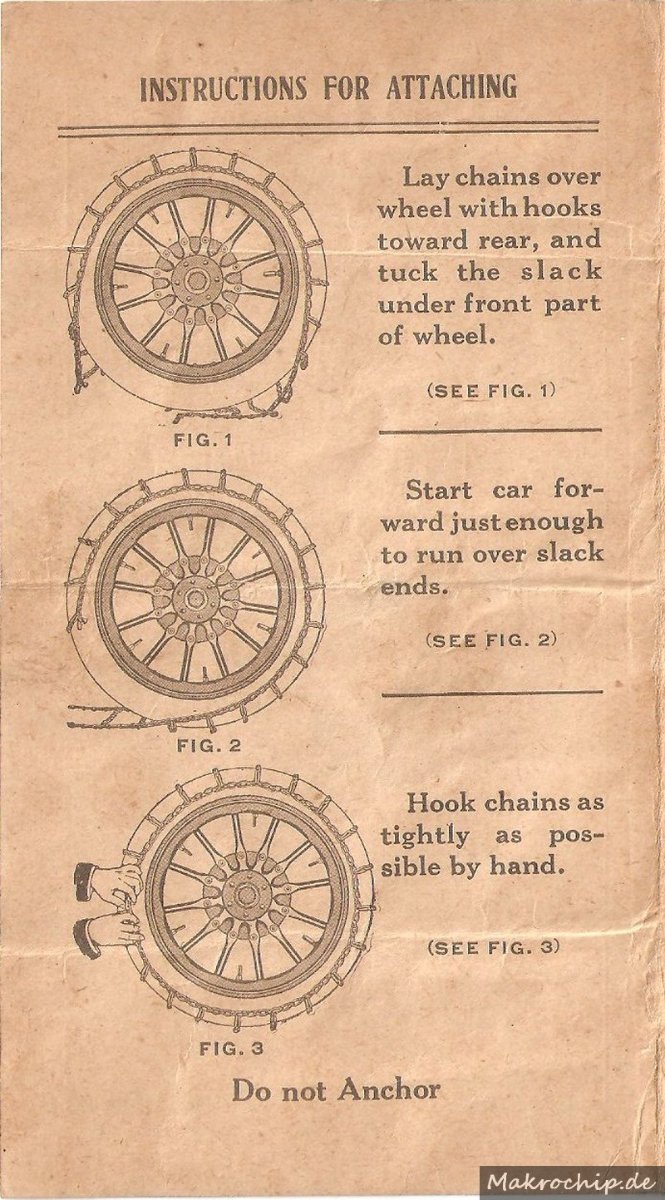

I found scans of an original instruction brochure online, here are the first three pages. Due to the 5 pic limit, I will put pages 4-6 in the next post.
