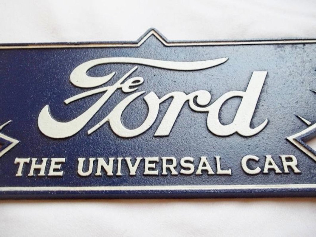

A Google image search brought up this one in cast iron.

We have seen what is available commercially today, like the cast item above. We would like to have more depth/relief to the background.
