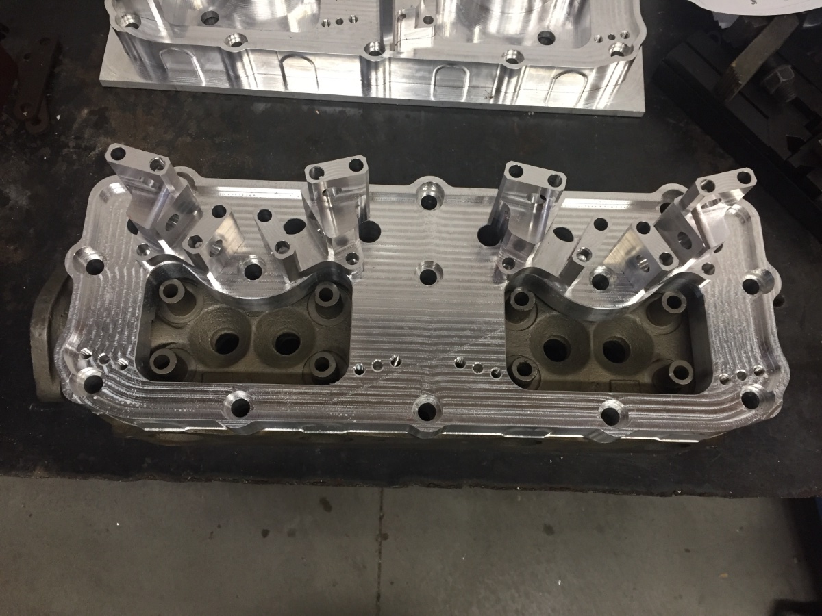

After 4 hours in the mill, time to make some room for the bushings...

I do have to admit that a more modern mill could have done the same work in half the time or less... but that requires the one thing that didn’t make your list... MONEY!!!

Am far enough along now to mock up the first sanity check...
Then got to thinkin... sanity’s got nothin to do with this project!!!

Re: Obscure speedster trivia...?
Here is a shot of the latest design revision to the adapter plate... was hoping to make the plate appear a bit less “billet”
It looks like a piece of art ! I wish I was that talented.

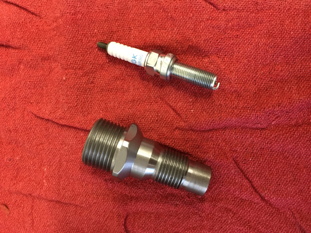

Been “plugging” away at the spark plug adapters. Found these 10mm thread spark plugs with over 1” of reach. Needed the long reach to be able to extend the electrode down into the combustion chamber, rather than being recessed up in a hole.
The extra threaded section is for a spark plug tube that reaches thru the top of the valve cover. The spark plug tubes also double as the valve cover hold downs
Nicely done! The spark plugs adapters you spoke to me about look great.

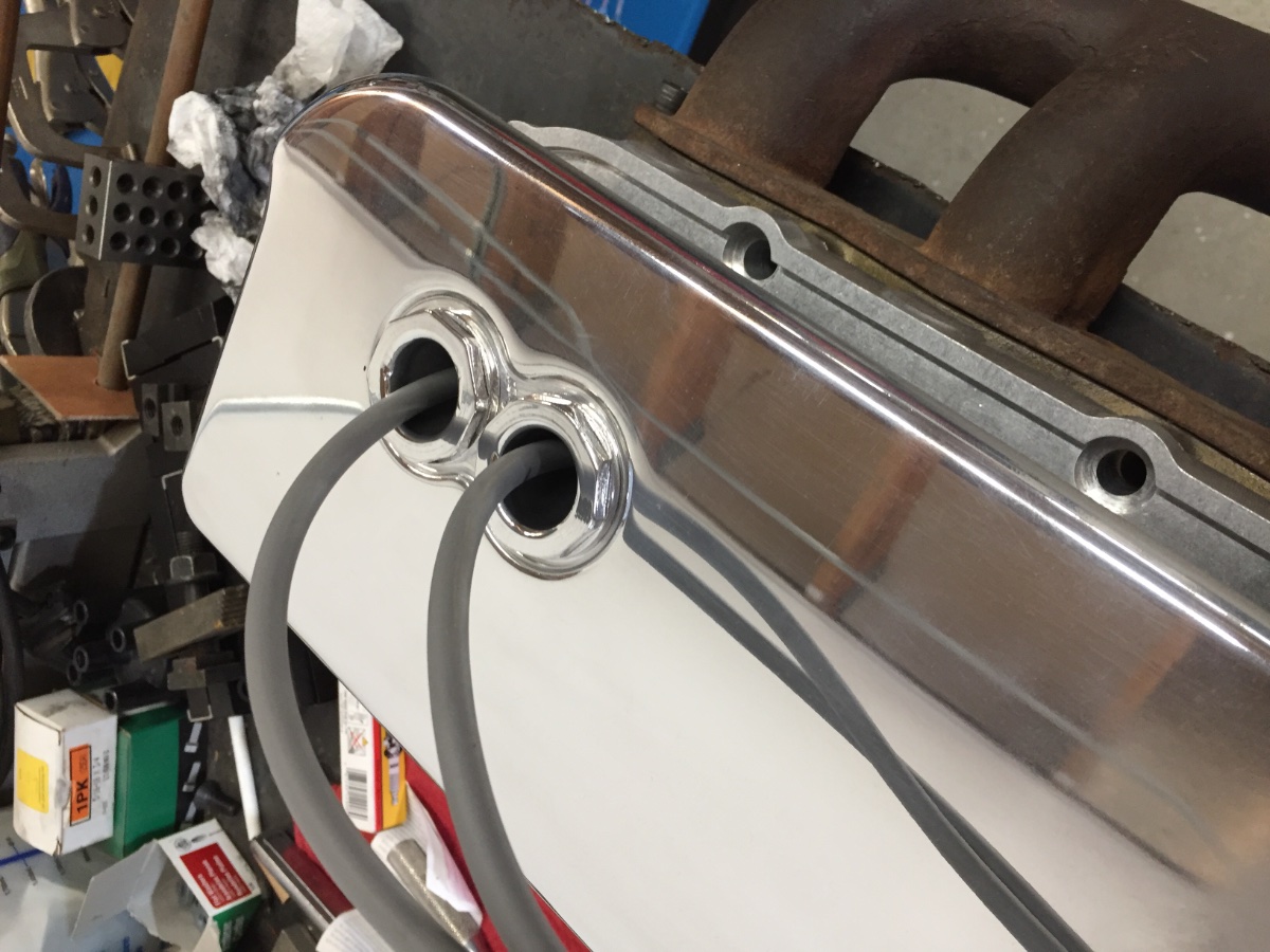

The top panel of the valve cover is done... is it starting to look like the picture yet??
The top panel has 1/8” of crown in it to combat the “billet” look. I should have made a vacuum plate to suck the cover down and prevent vibration during machining... but I didn’t! Oh well! So there a few grooves and gouges but once they are blended out and polished they will simply be waves in the finish and will actually help the cover look less “billet”
The valve cover will be a welded 3 piece assembly when finished. The top panel, a machined base ring to blend the top and bottom profiles, and the current plan is to bend a 2” wide strap to connect the 2 pieces. I considered a casting, but it would have been almost just as much effort to build the required pattern. All this effort to only yield 2 pieces... not worth it!
I'm surprised it's not see through so the masses can appreciate your rocker arms.
Andy
Andy
Kevin Pharis
Topic author - Posts: 1642
- First Name: Kevin
- Last Name: Pharis
- Location: Sacramento CA
I considered the see thru option at first... but got derailed once I realized how complex the wiper mechanism would need to be...
