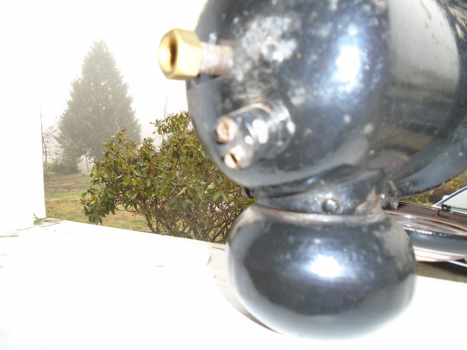

These photos show how mine work.
The wire clip carrying the bulb holder simply fits into the groove around the light and the wire is threaded through the vent at the top.
Here the clip is removed to show details. These are tail/stop lights using a two pole socket. The slde connectors enable them go be easily removed.
