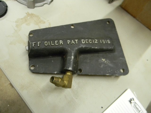

This is the one I use. Incredible amount of oil.

I use ione like John's pictured
1 piece cast door these where made by Max Edmonds in 70ss and 80s
No holes to drill and run hollow bolt like the mag post oiler
Bendix is my second favorite way but usually not an option
as most of my T's are non starter

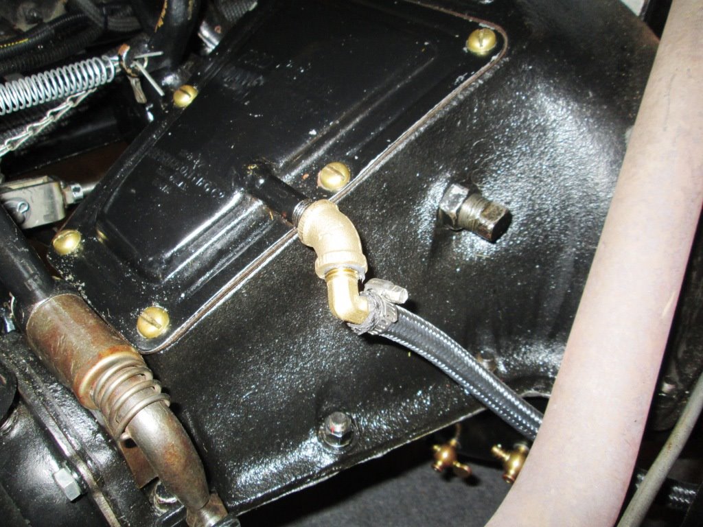

Here is what I found, last year, as I bought the "1915" touring.
I don't like it because the oilline goes over the exhaust.
Andre

Andre - the oil line should exit the oiler & go under the pipe and yes, I run original Ford Faithful Oiler's on all 5 of our T's - built in debris screen and with the topography here in the Pacific Northwest, a little lubrication insurance to the front of the engine is good !
Only drawback to the F.F. footplate (oil inlet to c.c.) is when one does a full oil change service requiring dropping the lower cover (where the footplate attaches) to remove the lower cover retainers (horse shoes), it needs to be removed also requiring new gaskets being made. I just "modified" the F.F. oiler on the '14 Touring which I drilled into the side of the c.c. just adjacent to #1 rod trough & installed a fitting to receive high pressure, high heat reinforced racing oil cooler hose - no leaks & no interference removing the lower cover - photos will come later.
