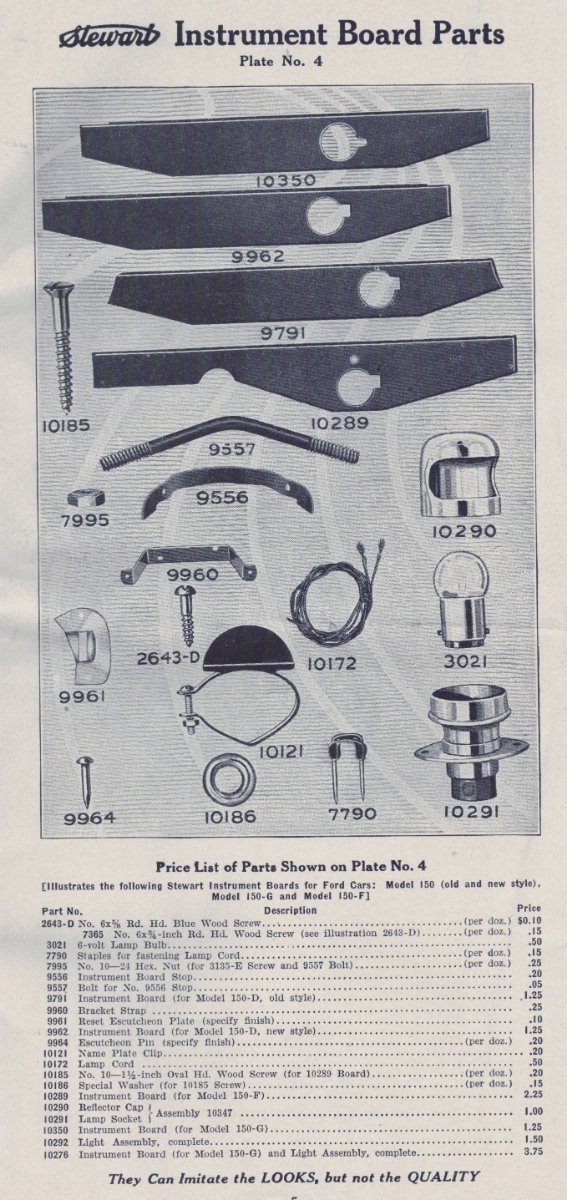

If you get a Stewart speedometer and are fussy, the letter (date code) on the face should correspond with the model year of your car.
Stewart made both metal and wooden instrument panel as an alternative to mounting the speedometer on the firewall.
The original owner of my 1917 roadster purchased and installed a metal Stewart instrument panel. My dad has a couple NOS wooden Stewart instrument panels.
You can see examples of metal and wooden Stewart instrument panels here and information from the very knowledgeable Russ Furstnow:

Since you don't have a dashboard, the most common application was to use a "drop down" bracket that mounted to the cowl, just below the windshield. There were several manufacturers that provided this type of setup (Sears-Cross shown), with Stewart Warner being the most common. Here are a couple of photos of the type you could used. Also, Stewart Warner offered a dashboard for the Ford that mounted the speedometer (see the variety of dashboards in photo). I hope this helps.

Model T Haven has a speedo mount listed on their ebay store right now similar to the one in Russ's post.

Why not just install a firewall mount like a 13-15. You will have many choices. Stewarts are the most common. If you need everything, I would count on spending as much as $1000, but it probably won't be that much.
