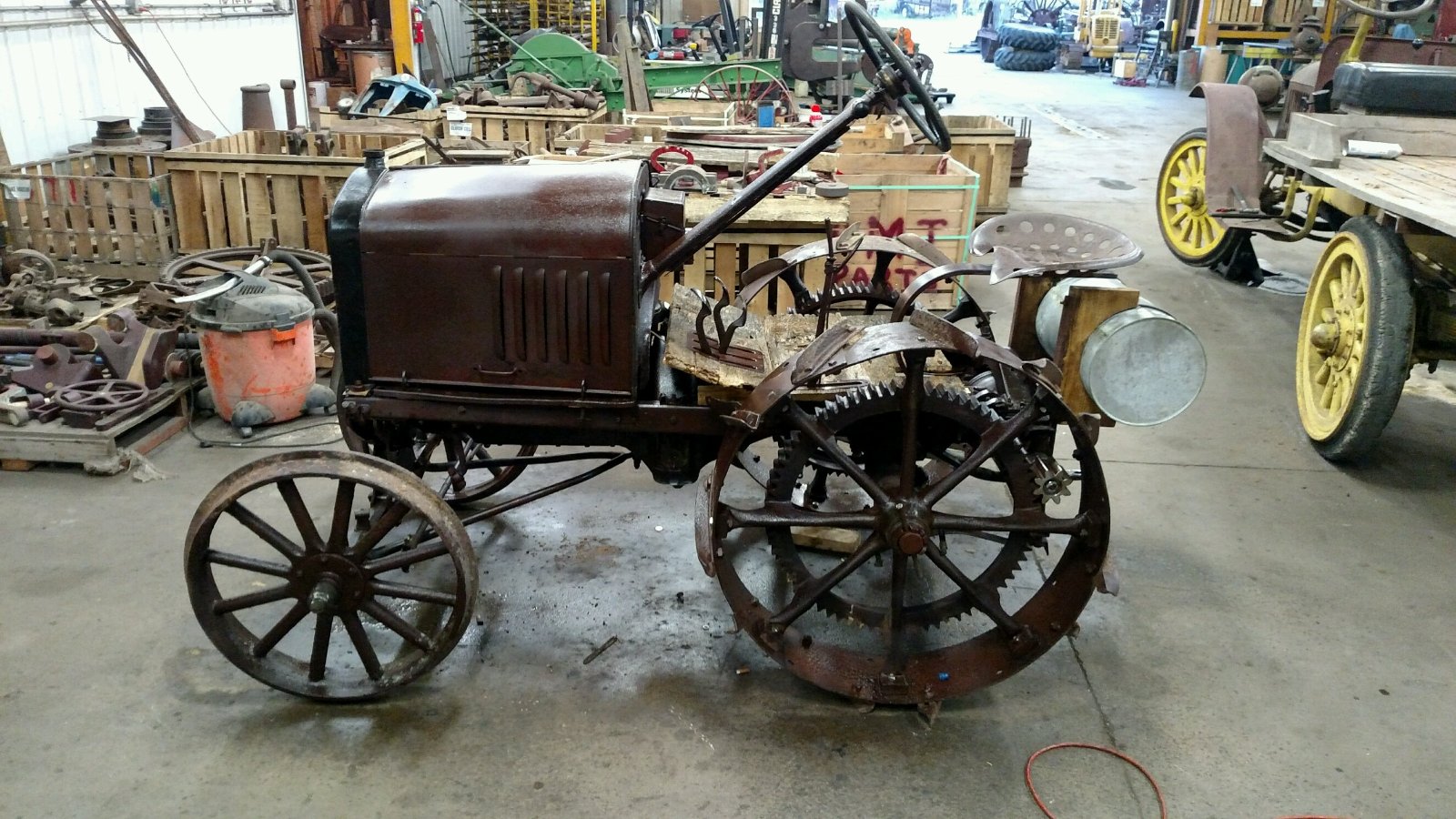

No worries Scott.
In a year the top will match the existing paint. I'll make a point of it. These are a couple of my restored T's.
