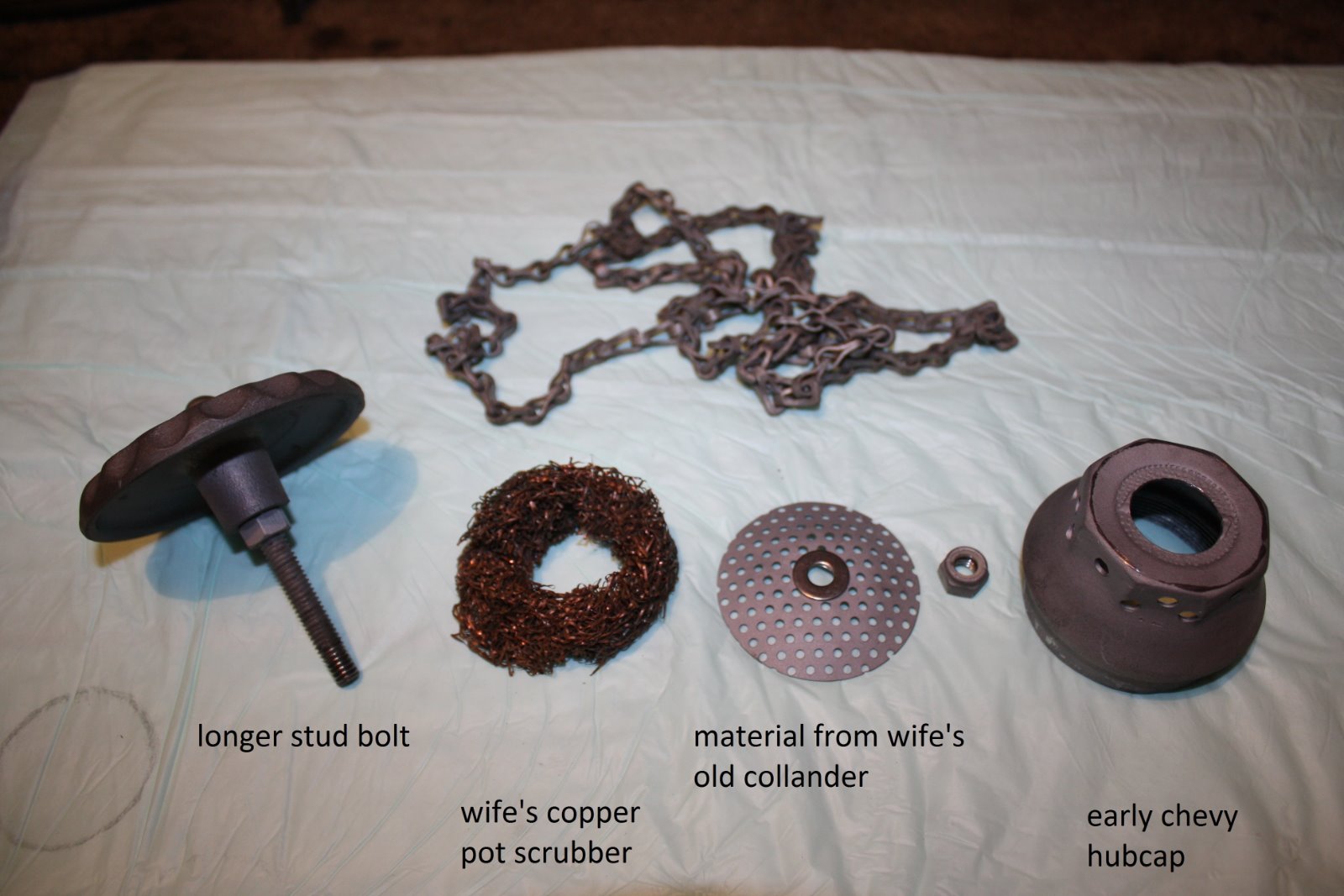

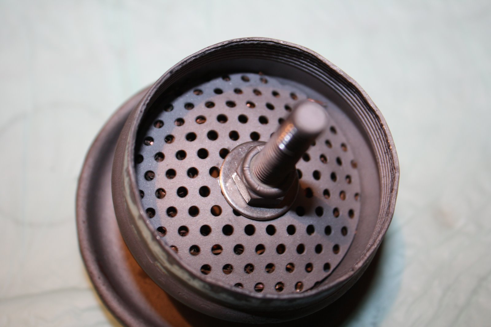

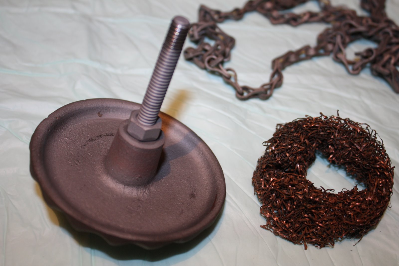

I think I can screw a 1/2 inch "bayonet" style pipe fitting into the hogs head, where the mag post is supposed to be, and hook a rubber hose to it and run it to a vent position somewhere high on the cowl. That should stop any oil leaks. (I think)
Here are some photos of what I built today. It may be a little "over engineered" but I think it will work OK. The first photo shows my complete setup with the stock oil fill cap in place without my new accessory crankcase ventilator ... "an accessory on an accessory
It is built with scraps from around the house and an old chevy hubcap (possibly a 490 ??)

I think that's more than enough Donnie. If that breather doesn't handle your blowing you have bigger problems.
Andy
Andy
- Posts: 5442
Re: Another Columbo cross drive magneto question, crankcase ventilation ??
Looks great, but I would think that chore boy would not be needed. Example there are times of the year that I have a real condensation issue with my engine. If I have a cap on with the screen, the moisture just collects in the fill spout area, if I take it off or use a cap with out screen it seems to evaporate better. I am thinking as high up as that neck goes I don't think oil coming out should be an issue.

Mark, Good point. I will keep an eye on it. I mostly added the mesh to keep out bugs. It is a simple matter to remove the mesh if I need too.
