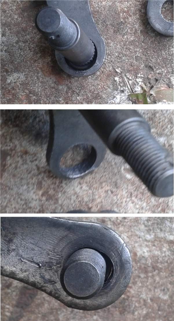

These new fangled spring shackles wear funny
Post by Mindless Automaton » Fri Feb 01, 2019 4:55 am
I know I should be glad that these are available but I really should have ground some of the serrated edge off. When it touches the spring or perch they tend to bite & then the shackle itself wears in places that it shouldn't.
Thinking of re-making the worn parts in 8MM steel rather than the 5.5 MM they're currently made from.
The moral of the story is, if you haven't examined your spring shackles closely lately, it might be a good idea to do so.

This type of shackle has been discussed some time ago on the old forum. You are right, they suck. As far as I'm concerned, they should be banned. JMHO. Dave

I'm only two years into Model T's but I could see, even with my novice eyes, that those new repro shackles were no bueno.
It took me a while, but I found a good set of used original Ford script shackles that'll be installed this weekend. They're not perfect but they fit nice and snug inside the brand new bushings I bought, so I'm happy with them.
I've heard the repros that Chaffins makes are also good. As soon as my car is finished mechanically, I'm going to buy a complete set of everything that will wear out on the car and stash it for the day when all these suppliers are gone. And...a set of Chaffin's shackles is on that list.

The insidious thing about many reproduction parts is when they are not equal to the originals in design and materials, they are prone to early failure. I say "insidious" because it's the nature of the hobby that more often than not, they are installed on cars that are seldom used, and rarely see the kind of service that was common in their using life, so the perception is that if they fit the hole, they're just fine.
Not so for cars that see a lot of road time. Per Murphy's Law, they'll fail at the worst possible moment, usually on a tour, and far from any assistance. We have to be our own quality control nowadays if NOS parts can't be had.

My car developed erratic steering problems 2 years after a complete front axle rebuild. At the time of the rebuild I saw no need in spending the extra $ on the forged type shackles, so the new ones that I installed were the less expensive stamped type with the knurled pins. Upon inspection the wear of the end plate was easy to spot. This wear, created lots of "wobble" in the pins allowing the camber to constantly change depending on the road, bumps, and contour of the pavement. New forged shackles were installed and good steering was restored.
The WOBBLE Maker. Some may call it the WIDOW Maker.
stamped shackle wear2.jpg (24.72 KiB) Viewed 10129 times
Do you see the severe wear?

I think if you look around you will find lots of this style shackle in use on many cars. I am going to go out on a limb and say it is not the design, it is the material used, grade of steel and hardness.

Welding the knurled shackles would be a help. Big problem with repro stuff is that you cannot know what grade of steel was used. I would hazard a guess that the knurled design with an acceptable alloy would still be a problem past a certain amount of stress and use.

One wrap of aluminium welding wire seems to space them out from the bushing far enough that they will not present a problem. For now.
A washer would be better.

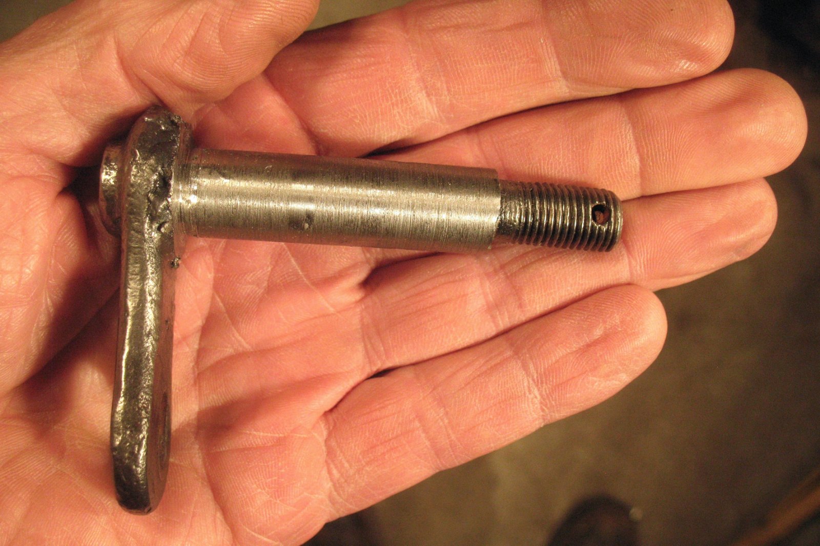

While not plentiful, L shaped shackles are to be found. GOOD usable ones are a rarity. Re-building the L shaped ones is not too difficult if you have a mig welder and access to a lathe. I made a tool to hold the welded shackle in the lathe. It is simply a short length of old T rear axle with a drilled and tapped hole in one end into which the shackle thread is wound, until it bottoms out on the shoulder on the shackle. I then use a centre drill to make a relief in the outside of the shackle, and the shaft is turned down between centres. When done, the relief can be filled with your choice of goo.

I’ve heard many people say they weld up shackles and turn them down. I’m sure this makes a good looking shackle, but the T shackles are hardened and a welded up shackle doesnt have a hard enough surface. Unless you harden them they will not last long. This could be okay for some vehicles that don’t get driven much, but I just wanted to mention this so people that have “welded up” shackles on their cars keep a close eye on how they are wearing!

I'm using built-up shackles, but with bronze bushings. I hope the wear will be on the bushings and not the shackles, but I guess I'd better do an annual check to see how they're doing.

Adam, Like Steve, I always use bronze bushes rather than the cheap rolled steel bushes Henry and the vendors supply. They have an added advantage in that they can be reamed for a custom fit, should my machining of the welds be a little off spec.
I buy new figure 8 and Mae West shackles for early cars. The rebuilds are confined to the forged one piece L type which are not reproduced.
