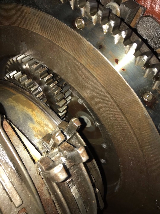

The triple gear pin must be broken in order for the gear to touch the flywheel like that :( Looks like a nice car otherwise

I think the pin may be broken as well. We will have to see once I open up the engine.

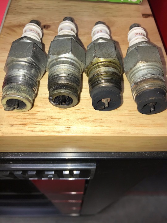

The are the plugs back to front Left to right. Any comments? Look normal? Looks a bit rich to me on two cylinders.

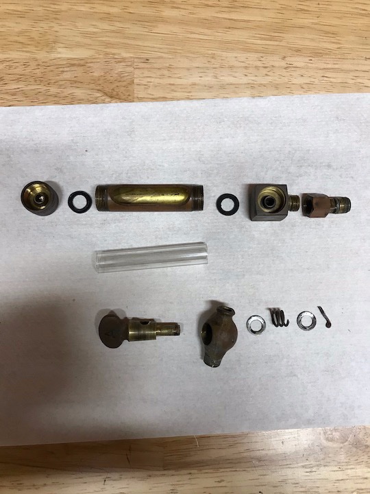

The oil line.
More to go.....

Re Sparkplugs
generally speaking, the front, #1 plug will run the coolest and rear #4 plug will run the hottest. It is the nature of the beast with respect to coolant flow.
That said, nearly every as-is car I've worked on, has cheap $2 paper gaskets at the intake/exhaust manifold glands. They invariably are deteriorated to the point of failure. It looks to me that you have an intake leak and to run, the carburetor is set to very rich to keep the car running. This results in two plugs running very lean and two plugs running very rich.
Use these: https://www.modeltford.com/item/3063-64.aspx if your exhaust manifold is straighte enough (it almost surely won't be), so if not, use these: https://www.modeltford.com/item/3063MC.aspx
If you want to have high probability of failure and warp the exhaust manifold further, use this: https://www.macsautoparts.com/ford_mode ... erial.html which of course you don't want to do..just wanted you to see what an inferior product looked like

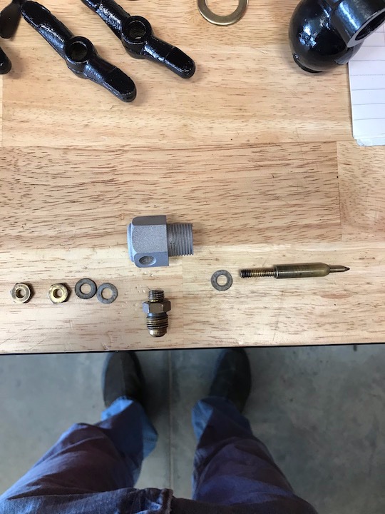

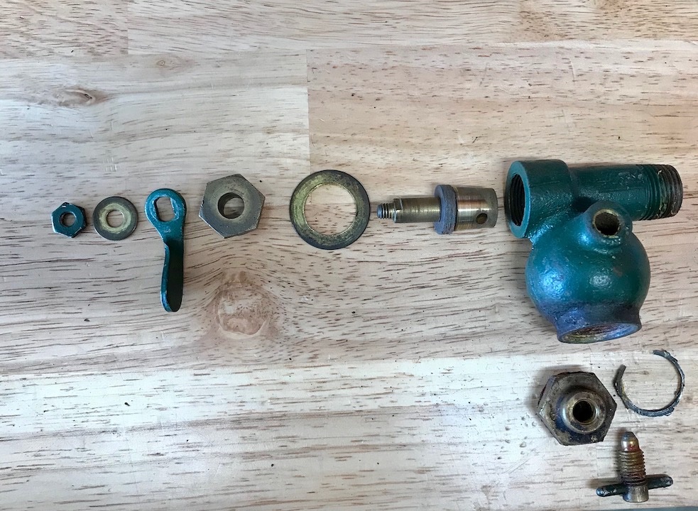

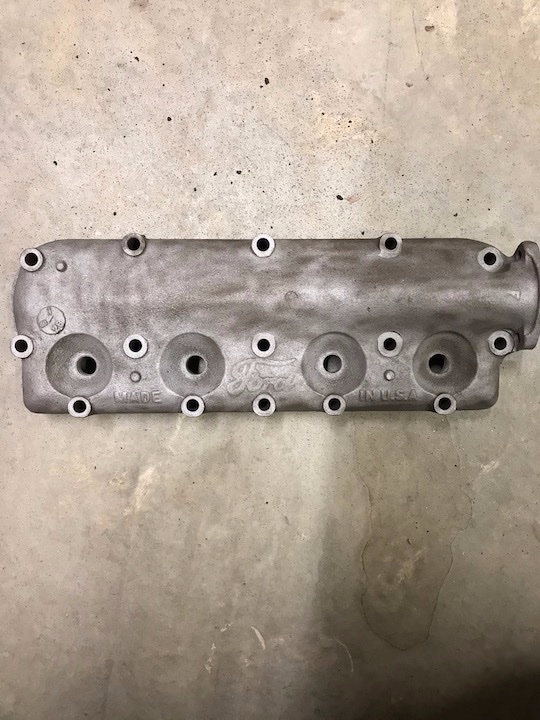

I just put an order in for a bunch of blots and odds and ends for the engine. Most of the bolts were the wrong length, etc. Got a question. Who makes the 1926 Water inlet with eccentric? I've seen several for sale with different prices. Some with the hardware some without.

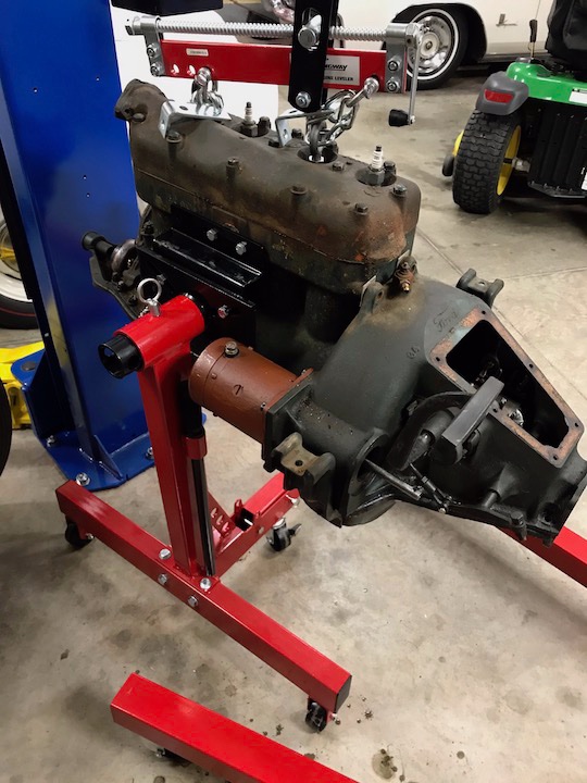

Well so far today I got the plate mounted to the engine stand.

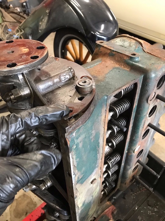

So this is what the valve spring area looked like.
Looks clean.

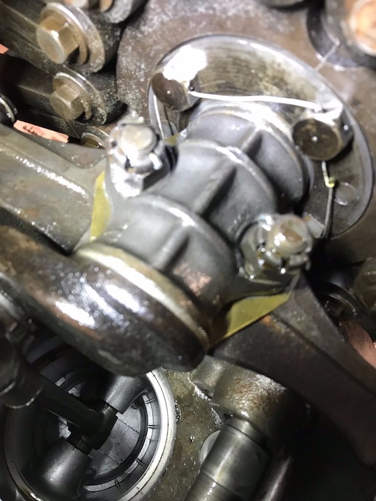

This is why you need to check your T all the time. They guy who put this car together neglected to put any cotter pins in and I found one of the bolts loose.

Well I got the engine out after work today!!!

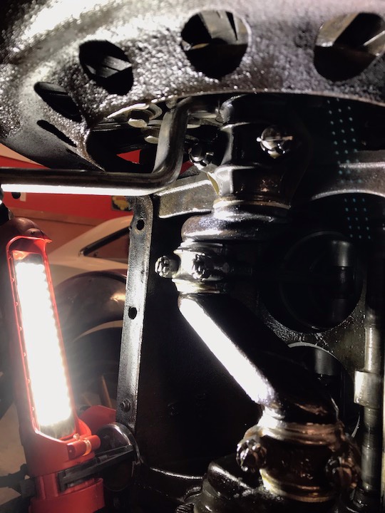

When I took off the Rad Rod I found not cotter pins and different size springs. That's not good.

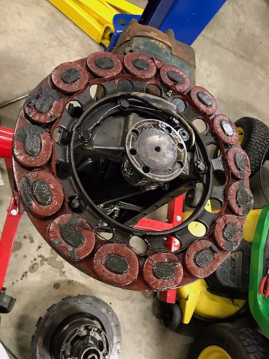

So now I can see two issues that I had known about . First the Mag Ring is the wrong year. That explains why my starter wouldn't come out.
Then I saw that one of the pins was broken on this triple gear. I hope that's the only issue..

Looks like you're making good progress. Those wishbone ball cap studs/nuts need to be wired to each other, not cotter pinned. If you use cotter pins, the nuts will be retained on the studs, but the studs can still back out from the pan.

Well today I got the Pan off. here is a look inside.
https://www.youtube.com/watch?v=HpwDrVDo_No
As you can see the triple gear is jammed against the flywheel. The pan looks real clean. Some sludge in the bottom.
So I was told in my post that the bands were ground and needed to be replaced. I don't see any marks on them. Do they look ok?
Posts: 6714
Re: Getting Rattles Back On The Road
Post by Scott_Conger » Tue Jan 14, 2020 10:36 pm
They do in fact look fine...just installed backwards
Consider new lining material based on reverse band
Purchase Repairing And Restoring The Model T Ford Transmission and also do some searching on the MTFCA forum for discussions on triple pin bushing clearance. Reading the book and studying the volumes of info on the forum, you will find key things, like how to press out the pins without destroying the flywheel, and what sort of clearance the bushings should be to the pins. Yours were likely set too tight at the last rebuild. Finally, I'd strongly suggest you purchase new bushings from Bob's Antique Auto. They are the closest things to the correct material, and that is important. He supplies them to some, but not all other suppliers, and I don't know which is which, so stick with Bob's.
This is going to undoubtedly be a learning experience for you. Good luck and go slowly.

So I got the transmission of the engine today.
The first thing I noticed was the safety wire was not connected that well.
I was now able to get in my head and see how this wrench is used.
This is my Transmission Selfie!

So this is not the correct Mag Ring for a 26/7. Explains why I could not get my starter out.

Post by Mopar_man » Mon Jan 27, 2020 10:49 pm
Well I went out to check my pistons after a call to Lang's with questions about installation. The guy who rebuilt the engine used aluminum pistons and yes the split of the side of the piston was facing away from the cam shaft. still odd that the number 1 piston has the wrist pin bolt facing the cam shaft and 2,3, and 4 are facing away from the cam shaft. I'm not so sure how many miles are on the engine so if I remount the 2,3, and 4 rods on the wrist pins and crank I run the risk that the bearings (that are currently worn in the way they are) are going to wear unevenly. I plan on redoing the cotter keys. They didn't leave one side long so they may not hold against the rod and one was missing.
Posts: 7143
Post by Allan » Tue Jan 28, 2020 6:58 pm
Robert, I admire your enthusiasm and willingness to have a go. It is a really good way to learn. Equally important is your seeking advice as you go so that you are up with the combined knowledge of a host of other T owners.
In that spirit, I suggest that special T wrench used to undo the four bolt at the crankshaft flange is nice to have but not really up to the task when rebuilding the motor. Those 4 bolts must be tight, and then a bit more, before they are safety wired. Pressure applied to a wrench with that much of an offset causes the wrench to twist off the bolt head, before it is truly tight, and with damage to the head. I use a ring spanner,[box wrench] specially bent to keep it as straight as possible, so that pressure is applied in a straight on pull. The ring spanner also engages far better than an open end wrench.
The original factory timing gear nut wrench also has a similar offset, and it to cranks off the nut, damaging it as it goes. I made a sleeve and washer, held in place by the timer roller nut, to keep that wrench engaged on the gear nut until it was tight.
Keep up the good work.

Well I got some more done today. I'm not sure why people have such a hard time with the gas tank on a 26 touring. I mean after I pulled the engine, steering column, and dash board it came right out. Ha!! :lol:
Here is a video of what I found. The tank looks great on the outside. Unfortunately the inside is lightly rusty. I'm going to send it out to the place where they take it apart and seal it.
https://www.youtube.com/watch?v=6q9CjmZNZM8
Then I took the head off. I saw that the guy who had the car before me added some washers to three of the head bolts. My guess is that there is some junk in the hole and instead of cleaning it he just added a washer to take up space. I got a new set of head bolts and head gasket. I'll remember to put the gasket on correctly. :roll:
This is what I found when I got the head off. I'm not sure if this hole I pointing to is supposed to be blocked by the head gasket. All the steam holes looked good.

Post by Mopar_man » Mon Feb 03, 2020 8:13 pm
Well tonight in VA the temperature was 65 so when I got home from work out to the garage I went. Today's work consisted of getting the blast cabinet working. I changed the nozzle out and now it works. I'm going to change the media out next. I also cleaned off the tops of the pistons and the valve seats. Like I was saying the motor was rebuilt and didn't have many miles on it. Here is the after.
John Warren
Posts: 1071
Last Name: Warren
Location: Henderson, Nevada
Post by John Warren » Mon Feb 03, 2020 8:42 pm
Looks like you have something to start with, The bores look glazed,so it may have more miles that you think. Great time to look it all over. At least bead hone it and new rings. Check valves, adjustable lifters are nice. Make sure it has a good cam gear. I like the stock ones. They make better cams , and some people advance the stock cam 1/2 a tooth. Higher compression always helps. I installed high compression pistons in dads car and it was very noticeable along with advancing the cam. Looks totally stock. Thanks for sharing.

Post by Mopar_man » Tue Feb 04, 2020 8:23 pm
Thanks John. In looking at the cylinders I can still see the cross hatch scratches on some. Then again who knows. I'm just glad that it was rebuilt at some point. You sometimes never know until you open it up. Ha!!
Mopar_man
Posts: 1172
Last Name: Govoni
Location: Fredericksburg, VA
Post by Mopar_man » Tue Feb 04, 2020 8:25 pm
So tonight I got my blast cabinet running good and cleaned up the head.

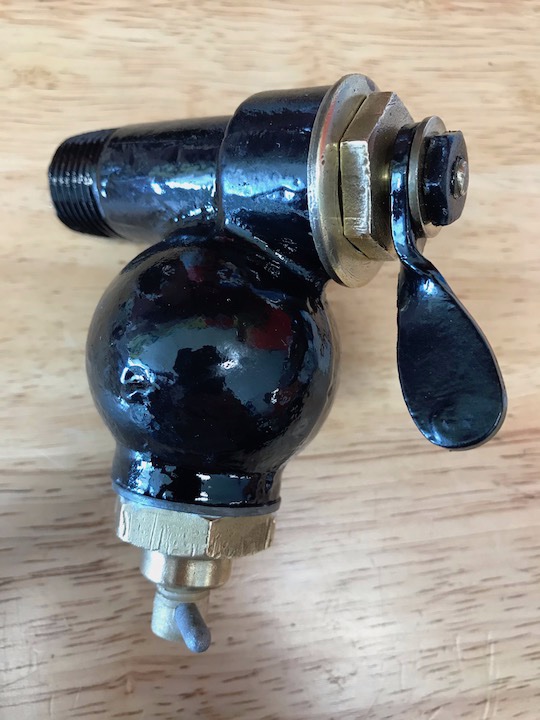

Well today I cleaned up some bolts and then went to work on the sediment bulb.
This is what I have to work with.
Found out that there was no screen inside.
This is what it looked like when I got it all apart. I have the rebuild kit for it.
Question: If I put this in my blast cabinet will I mess up the threads? I'm using a mild abrasive "Black Beauty".
Posts: 7395
Post by Steve Jelf » Sun Feb 09, 2020 3:53 pm
I would expect the threads to be OK, but I would duct tape the tapered cylinder and stuff paper inside the body to protect the mating surface.
Mopar_man
Posts: 1172
Last Name: Govoni
Post by Mopar_man » Sun Feb 09, 2020 4:26 pm
Good Idea. I'll see how much I can blast out from the other end. I'll be careful around that surface. Thanks!!
Scott C.
Posts: 856
Last Name: Clements
Location: Waynetown Indiana
Post by Scott C. » Sun Feb 09, 2020 7:39 pm
You might want to use some lapping compound on the tapered surface. Also, buy some of that EZ Turn lube that Lang's sells. It works really well on the fuel valve.
Mopar_man
Posts: 1172
Last Name: Govoni
Post by Mopar_man » Sun Feb 09, 2020 9:04 pm
Thanks for the tips. I was wondering how I was going to clean it up.

You think black beauty is a mild abrasive? I always understood it was much more aggressive than glass beads.

Mopar_man
Posts: 1172
Last Name: Govoni
Post by Mopar_man » Mon Feb 10, 2020 8:48 pm
Scott, Is the EZ turn Lube for the threads to seal them from mass leaking out or for the pard that I could Lap in to make smooth just behind the Packing? The guy who had the car used teflon tape. That's not good.
David, You are correct "Black Beauty" is very abrasive. I should have been more clear I'm using the fine "Black Beauty" It comes in many variations. I had to change from Glass it wasn't working as well on some of the hard rust.
Scott C.
Posts: 856
Last Name: Clements
Post by Scott C. » Tue Feb 11, 2020 1:21 am
There is a leather seal that goes around the shaft and then the brass fitting compresses it to make it seal. The EZ Turn lube is impervious to gasoline and lubes the brass valve and the leather seal. I used liquid Teflon to seal the pipe threads at the tank.
Mopar_man
Posts: 1172
Last Name: Govoni
Post by Mopar_man » Tue Feb 11, 2020 9:21 pm
Thanks Scott! I ordered the EZ Turn.
Posts: 6714
Post by Scott_Conger » Tue Feb 11, 2020 9:32 pm
If you truely believe that the plug requires lapping, you will want to use TimeSaver Yellow, for soft metals. Apply per instructions (mixed with oil), and work the valve into the body gently...let the compound do the work. Too much pressure, too much time, or too coarse of a complound and you will remove too much metal from the plug, score concentric rings on the plug which will weep endlessly, and end up with a "ring" on the large end of the plug which will forever be too big and will not allow the plug to seat deeply enough now that excess material was removed.

I also cleaned up the transmission for transport to MA in March.

Post by Mopar_man » Sun Mar 01, 2020 10:42 pm
Well I sanded the blob of solder on the Mag ring. Then I took apart the Mag post and cleaned it up as well as painted it. I still want to clean up the brass a bit more for a better contact.
Then i put together my Sediment Bowl. I used some EZ Turn and thread sealer that is used for gas threads. I hope it holds gas. I bought a gas line shut off that will go next to the Carb.

Post by Scott C. » Sun Mar 01, 2020 10:54 pm
Why is there a washer under the nut on the shut off valve? The nut needs to squeeze the leather seal in order to seal. Once working properly, you do not need another valve at the carburetor. This valve will do the job just fine.
Bill Dizer
Posts: 297
First Name: Bill
Last Name: Dizer
Location: Spencer, IN
Board Member Since: 2014
Post by Bill Dizer » Sun Mar 01, 2020 10:58 pm
Looking good! One question, is the exhaust valve on number three cylinder sticking open? In several of the photos there appears to be a large gap in the lifter to valve, and another photo or two the valve looks to be stuck open? May be just my eyes and the photo angle but thought I would ask!
Mopar_man
Posts: 1172
Last Name: Govoni
Post by Mopar_man » Sun Mar 01, 2020 11:13 pm
Scott, That washer was there when i took it apart. When I put it together it was loose like it needed to be tightened some more. I think I'll take it out and try tightening it without the washer. The exploded view I printed from the forum didn't have the washer there.
Bill, I'll check but it think it's just the timing from when I took the picture. I'll turn the crank and see if it is sealing.
Thank you both. Always good to get several sets of eyes on.

Post by Mopar_man » Sun Mar 01, 2020 11:25 pm
Bill You are correct I just went out to the garage (My wife said "you're going out there now?") I can see the valve is stuck. I hope I can free it up with a wood mallet. I'll then turn the engine over and make sure that they are all working.

Post by Scott_Conger » Sun Mar 01, 2020 11:38 pm
Easy does it Robert. A large faced hammer will not strike a square blow.
be sure to strike a square blow on the valve, and better yet, with a small brass drift directly over the stem, centered on the valve face. Be prudent. Consider soaking stem with penetrating oil first. Rotate crank/cam and get cam on heel. Tap valve closed. Repeat.

Post by Mopar_man » Mon Mar 02, 2020 3:45 pm
Scott, I took it easy and placed a wood mallet on top of the valve and tapped it with a rubber mallet after adding some penetrating oil. It moved no problem. I could almost do it with my finger. Then I turned the engine over with the crank and the valve went up with no issues and I had to once again tap it down. Did this several times and now the valve almost closes on its own. I'm going to let it sit and see what happens then try again. I may have to take it out and clean it up. All the other valves seem to be working ok.

Post by Scott_Conger » Mon Mar 02, 2020 5:46 pm
Excellent
This usually how it goes, but sometimes they can really be stuck! Glad this didn't fight you.

Well today I got the valve working as it should however after talking with John at J&M Machine I'm going to take the valves out and clean out the guides and make sure that they are clean. John is a wealth of information and nice guy. He will be rebuilding my transmission as soon as Bob's gets another run of triple gear pins done. Bob makes the best and I'm happy to wait.
I also cleaned up the Hog's head.

Post by Mopar_man » Wed Mar 04, 2020 8:24 pm
So tonight after work I started to clean up the engine pan. I took off the sight gauge and petcock. Then I took them apart and cleaned them up.
Question: Should the petcock have any packing on it held with the pressure of the spring?

Well I had a bit of a setback this weekend. I brought my transmission to J & M Machine in Southborough MA. First I am very thankful that I did. They were able to find cracks that would have spelled disaster had it not been checked. Two of my drums (Brake and Reverse) had cracks that were found once Magnafluxed. The other drum was very thin from someone turning it one too many times. The output shaft was gauged and banged up and cracks were also found in the clutch plate and fly wheel. I'll be replacing all that and more. This is a good example of pay me now or pay me latter. Had the drums just been cleaned up and used they would have come apart soon.
I have to say the shop at J & M Machine is impressive. We got a tour of all the machines that they have and what they were used for. I like what John said. "The Model T is a simple engine that is also very complicated. There is a lot to check and do so that everything works together."
They also have sent me pictures of the progress and are very helpful in offering advice and answering questions. If you need machine work done on old engines these guys are great. Hard to find people who work on old stuff.
So when I get done I may end up with a transmission that is worth more than the car but That's ok. I think Rattles will be with me for a long time.

Good to catch those things now. What are you using for the paint on the fuel valve?

For the sediment bowl I used Eastwood's black engine paint. We'll see if it lasts.

Well I got some pictures from J&M Machine. They make their own drums and like I said all of mine were cracked.
The Magnets have been all recharged.

They are looking for a 26/7 clutch plate for me.
