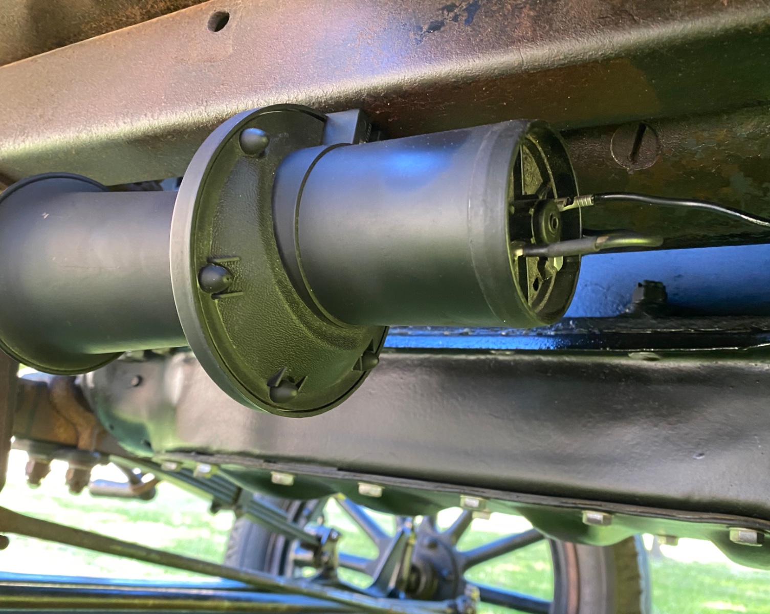

More little incremental progress while I wait for my axle to come back from Ross’s shop.
I finished the installation of the front spring. The original clamp cleaned up nicely. I like it when the Ford script shows on century old parts.

Then I cleaned up this accessory “belly band” engine support that came with my parts chassis. I’ve seen very nice versions but this one looks homemade. It looks like they took a piece of flat bar, bent it to the correct shape, then split it open in the middle. This piece would’ve had to have been made red hot then bent around a jig of some sort. I don’t see how one could’ve done so while under a car. Maybe they had another Model T pan to work with.
At first glance, it appears crude. But the more you look at it, the more you appreciate it.
On a high point restoration, this wouldn’t work. On this car, I think it fits right in.
It’s a testament to the fabricator’s skills that it fits so perfectly and installs so easily.

Post by RustyFords » Tue Mar 10, 2020 12:37 pm
Been enjoying the heck out of this wonderful little Flivver since the rebuilt front axle was installed and haven't really done much to it since then.
But I'm about to jump back in and tackle some more wood work in the doors and work on getting an interior put in it.
I keep going back and forth in my mind about correcting the "cock-eyed" look it has due to the driver's side headlight stalk being bent. Actually the whole front fender on that side, fender brace, etc is bent as well. All due to hard use on the farm. I'm leaning (pun intended) towards leaving it as is. It's part of the car's story and charm.
Another random note: I was shocked at how much camber it has now that the axle and spindles are rebuilt. It looks like too much compared to a modern car, but according to the manual it is correct.
My goodness I love this car.
