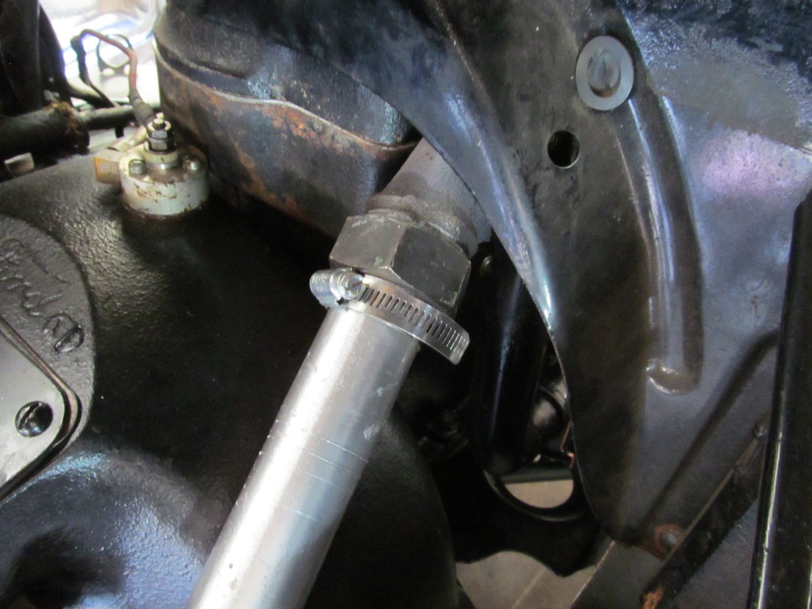

Well, if you go to remove that nut after its been on there for a few years, you may give anything for one of those wrenches! Don't even think about a pipe wrench......they ruin things in short order.
You might consider the exhaust nut retainer sold by the vendors. It's a very simple and inexpensive gizmo that holds the nut firmly.

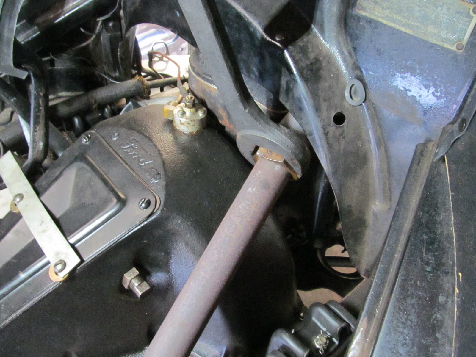

When I had an exhaust nut come loose on a trip, I was very glad to have that wrench under the seat. If you're lucky it's a $3 swap meet item.

The folks who have them come loose and use the retaining rings are the ones who have not used the Ford wrench. They are available as a reproduction now if you are unable to find an original. They seem to be slightly more expensive at around $50-$60 in my experience.

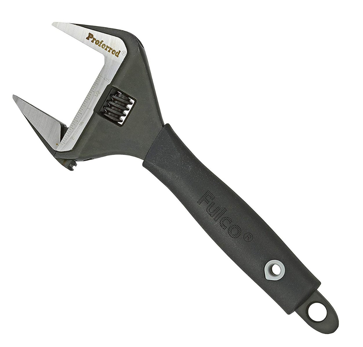

Definitely a great tool to have in your collection. I bought one that i thought was was an original, but turned out to be a repop that like others have claimed, was too small for the nut. Not a big deal, but some massaging of the wrench was required for it to fit properly.
Experience is a wonderful thing. It enables you to recognize a mistake when you make it again.

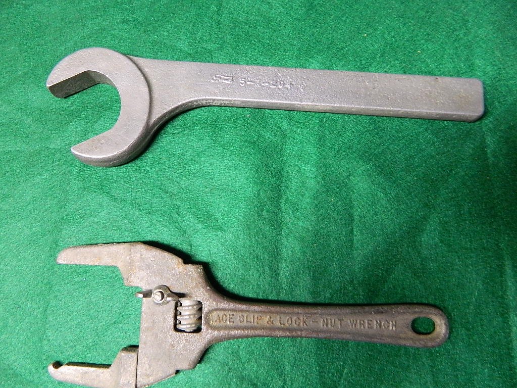

This is my exhaust nut wrench that I picked up this past summer at a garage sale $2.00 just an old wrench to that guy like gold to me. The other is for Raoul this is what I use for that type of nut on a toilet and under the sink on the basket nuts. Jim

On the exhaust nut wrench, you can get by with a big old fashioned monkey wrench. Not as good as the real thing, but . .. On the toilet nut, soak the nut with lacquer thinner. If the last guy used plumbers putty on the joint, that will loosen it up.

Jim - that plumber's wrench would be great IF the jaws were only 3/16" thick !
I have one like yours, and hunted all over town for a thin one. With the collar nut
installed with the collar away from the tank base, the regular wrench will not fit
in that narrow slot where the hex is. :-P

There is a reason that wrench has a short handle.
I added an 18 inch piece of pipe over the handle for extra leverage.
Then heated the nut area with a rosebud torch so the nut would turn.
That almost worked, but the whole end of the exhaust manifold turned easier and broke off.
If the nut turns too easy, it can loosen on a tour and the wrench is very handy to have along.
The little lock clamp that prevents the nut from coming loose is very good to have installed.

The Ford exhaust nut wrench is an essential tool. There are, as others have mentioned, other tools and tricks that may work in a pinch, but nothing does the job like the actual Ford z wrench. There are other Ford z tools that are also essential, but that is anothet topic for anothet time.

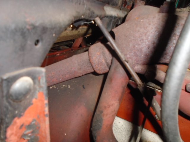

It's been noted that a number of exhaust pipes are not correctly formed. Whether the manifold pack nut stays cinched up tight often depends on how well the pipe is seated on the manifold, and whether gravity and vibration will work against its initial position.

:D Interesting that round pack nut. Did a check of 1923 Canadian Parts and Price list, same part as USA, #3061, plus the illustration in the Canadian Parts book shows hex pack nut! So original is it, or not, interesting round pack nut, guess you hand tighten or use a round wrench :lol:
Just used my repro wrench last evening, put on a new exhaust pipe, and changed out the old hex pack nut, as the threads were worn. The new nut rides on old manifold with threads that are so-so. But the pack nut wrench, Ford design, pulled it snug and safe.
Off with the old pack nut, after a soak with spray Kroil penetrating oil.
Lined up new pack nut, new pipe, centering the flange. Muffler removed to allow the exhaust pipe to remain centered for the flared flange to stay on the manifold flange. Good amount of anti-seize on threads helps with on and later off of the pack nut.
Old pack nut had compromised threads so it really wasn't holding firm enough.
Now even with new pack nut, tight with Ford style wrench, the radiator clamp is a good prophylactic for inhibiting that dreaded loose exhaust pipe :o
p.s. Even if this radiator clamp is redundant, it may come in handy on tour for other in distress with fumes in the cockpit!

Post by Original Smith » Tue Feb 19, 2019 10:36 am
I prefer the early style 3Z pack nut wrench that Dan posted above.

I'm all for using the original or reproduction wrenches. However, here's how I solved the problem since those wrenches would be pretty sloppy on my exhaust nuts. I have two cars, and both have nuts with flats measuring between 2.025" and 2.050". Some may suggest they're reproduction nuts; they very well could be, but I know they're at least 45 years old. This adjustable wrench has a nice smooth action, feels good in the hand, goes from 0" to over 2.4", and is only 12" long. It also fits in the nut area on the cars just fine. Yes, it costs almost as much as a Z wrench, but it fits perfectly regardless of nut size or if the nut isn't consistent between its three sets of flats. Plus, you can use it for a lot of other purposes. Just my 2c, in case it could help someone else out. I was extremely pleasantly surprised by the quality. The packaging said it was made in Taiwan.
https://www.amazon.com/gp/product/B016O ... UTF8&psc=1

Post by NHUSA » Tue Feb 26, 2019 12:38 pm
I got a large Harbor Freight (24 inch) adjustable wrench with a 20% off coupon a few years ago.
It is tight but fully open it fits the exhaust nut.
If the nut is rusty I use a flat file to clean it up before using the wrench.
NH - Where I used to live - not the carburetor ! :lol:
